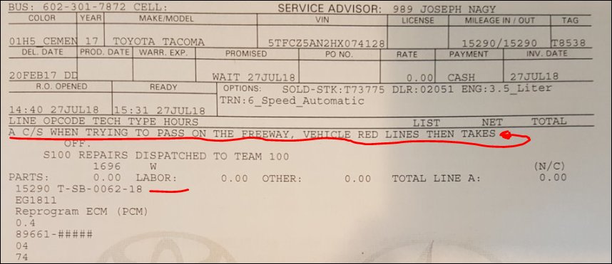

    Went in to my local dealer yesterday. Made an appointment for 2:00 today. Went in today and they applied the update from T-SB-0058-18. T-SB-0062-18 wasn’t even considered because it’s for “high altitude” situations. But from what I’ve been able to glean from other posts, it’s the basically the same. Seems to drive a bit different. Better. Didn’t get to put many miles on it to test it out. Time will tell. Hopefully the 3rd-4th shifting “flare “ will be gone and the shift pattern will be better.

    I'm not sure if Toyota is like Ford, but with IDS the pcm would be updated to the latest revision and include all previous updates.

    BS. I am in Phoenix.

    Either TSB 58 or 62 will get u to the same ECU update.
