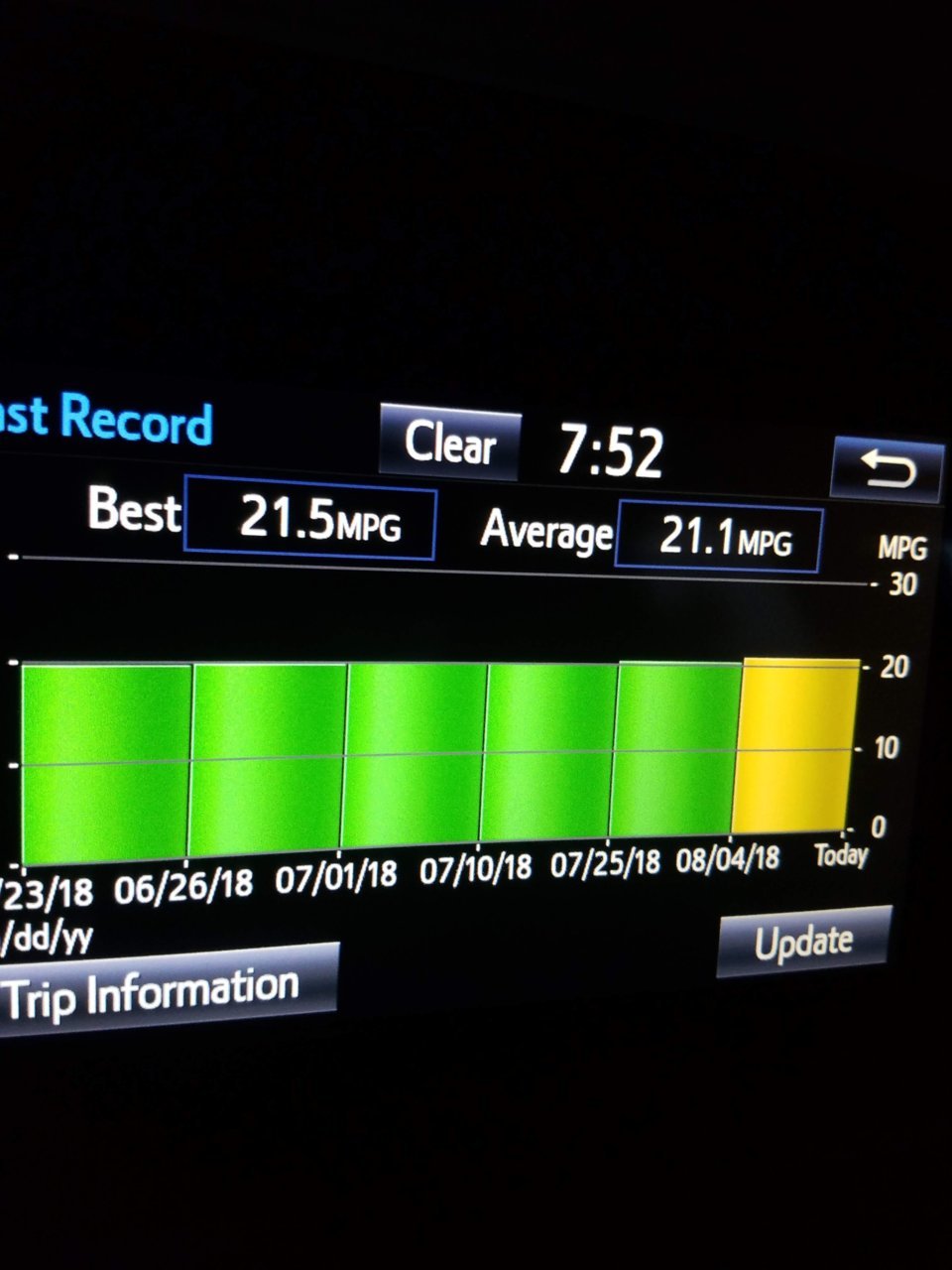

  14. Nov 13, 2018 at 6:46 PM
    #2794
    StayinStock
    Apr 8, 2018
    #249870
    41,833
    Bob
    Missouri
    Yes I do
    Some
    Looks about right
    Lt. Dangle[QUOTED] likes this.
  15. Nov 13, 2018 at 6:52 PM
    #2795
    Lt. Dangle
    Lt. Dangle RIP @stun gun 2016-2020
    Jan 25, 2017
    #208645
    7,655
    Ohio
    2025 Tundra Platinum OR
    That is pretty amazing consistency. You reset it after every fill up?
    shakerhood likes this.
  16. Nov 13, 2018 at 6:53 PM
    #2796
    StayinStock
    Apr 8, 2018
    #249870
    41,833
    Bob
    Missouri
    Yes I do
    Some
    That's just how she rolls.
  17. Nov 13, 2018 at 7:14 PM
    #2797
    Lt. Dangle
    Jan 25, 2017
    #208645
    7,655
    Ohio
    I'm pretty comfortable with 16 million miles of data.
  18. Nov 13, 2018 at 7:18 PM
    #2798
    RushT
    RushT Amateur Everythingist
    Dec 10, 2017
    #238171
    5,669
    North Texas
    '18 DCSB TRDOR Inferno
    Crap dude! Something’s broke in your meter. LOL. Or are you on a round the globe trip? Or perhaps commute 250+ miles a day?
  19. Nov 13, 2018 at 7:19 PM
    #2799
    StayinStock
    Apr 8, 2018
    #249870
    41,833
    Bob
    Missouri
    Yes I do
    Some
    I have no idea. It's always the same.
  20. Nov 13, 2018 at 7:23 PM
    #2800
    Lt. Dangle
    Jan 25, 2017
    #208645
    7,655
    Ohio
    I couldn't see a way to seperate the MT's from the auto's, or the 4x2 from the 4x4 on fuelly, but they are all the V6's. Given the combined ratings of 4x4 v6 tacomas avg. out to 19 MPG. i'm still failing to find this evidence of fraudulent ratings.
