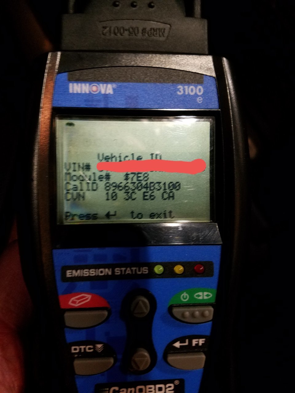

    My 2019 has #8966304B3100 from the factory.
