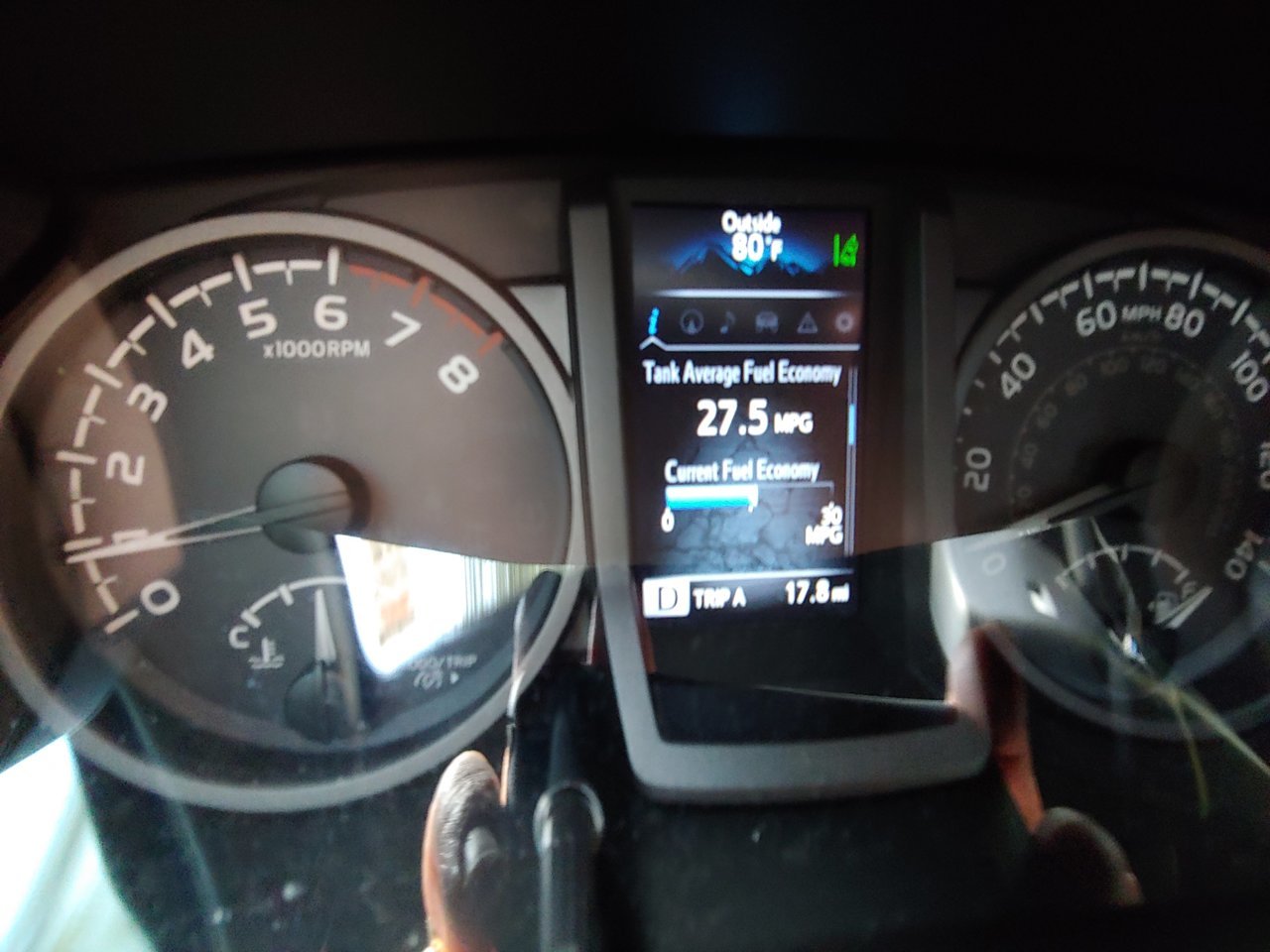

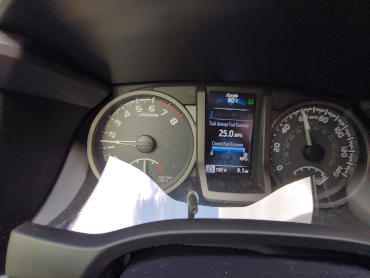

    I went ahead and took these photos on the way home yesterday .In the first one I was just getting out of the throttle because I was coming up on slower traffic. I had been running 60 to 65MPH. The second one was taken a few minutes later as I was turning off a major highway onto my dirt road. Sorry for the reflection as it was very sunny (you'll notice it was 80 degrees) and I was running the A/C.

    Some of us must have something wrong or are doing something wrong. I have a hybrid that I consistently BEAT the estimated mpg. 50 - 55 no problem.
    I drive similarly in my taco and get 15-16 same drive.
