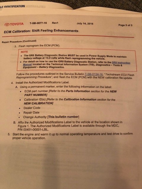

    Mighty Taco288, I found a PDF of TSB 0077-16, haven't found 0062-18 yet, but according to that SB after the install the tech is supposed to put the Authorized Modification plate under the hood next to the engine ID plate. and post the new cal ID on the placard. see attached pic. Im going to see about getting this done on my 19 Off Road soon.

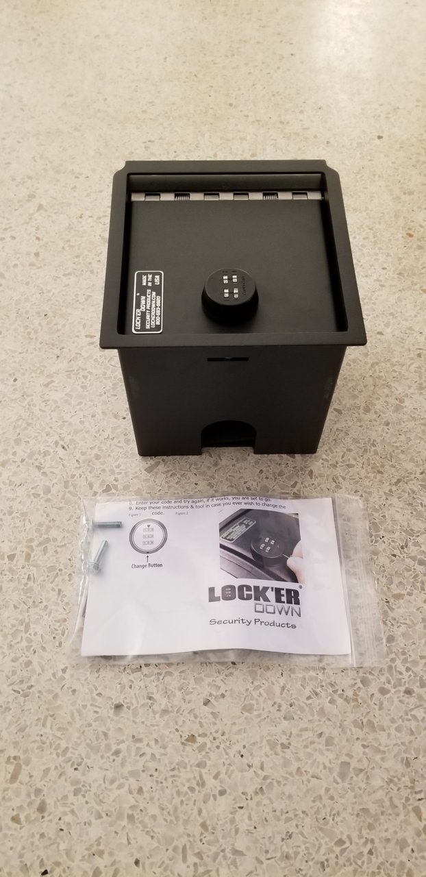

    The one accessory I took out of the old truck is the lockerdown console safe . It is for sale $230 shipped if anyone is interested.
