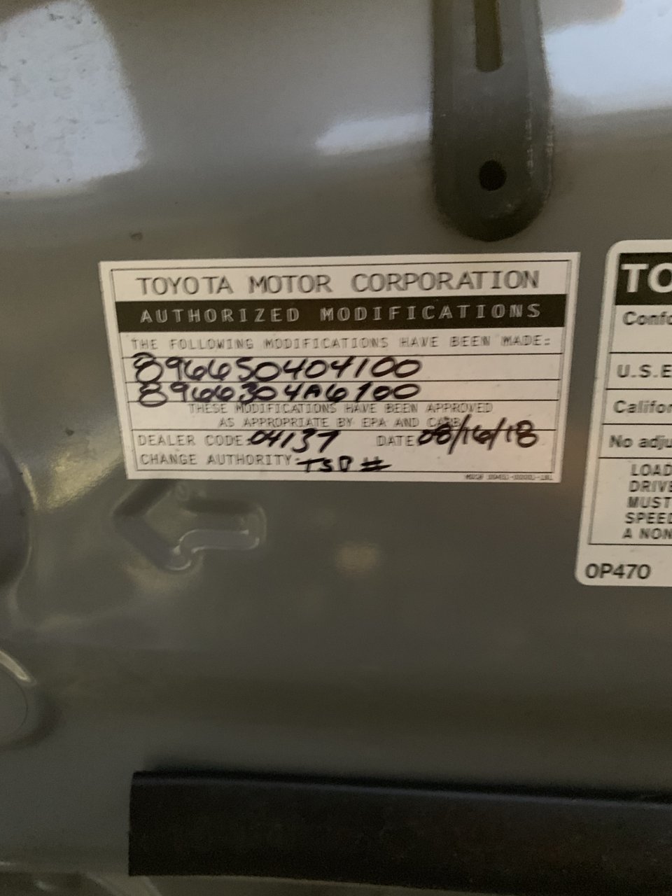

    I just looked at my sticker. It has 2 different serial numbers but no TSB number.
    Does this look like they applied the right thing?

    My difference was insane. Night and day. Get a techstream on it and see if they actually did it.
