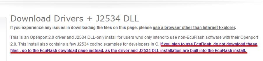

    In the TS software screen-read, there will be a calibration ID number. The last two digits will be zeros. The prior last 4 digits will be the four-digit identifier.
    A word of attention; when setting up the software for computer recognition of the cable, be sure and download the drivers (here) for the ECU flash functionality. That will also load drivers for merely using the software to read the ECU (if not flashing). You can use the simpler driver package but I say kill two birds with one stone.
