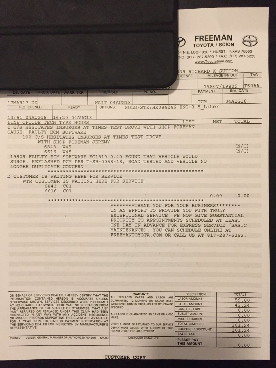

    Got it done at Freeman today and OH BOY IT’S NEAT
    Edit: I had the 0058-18 done.

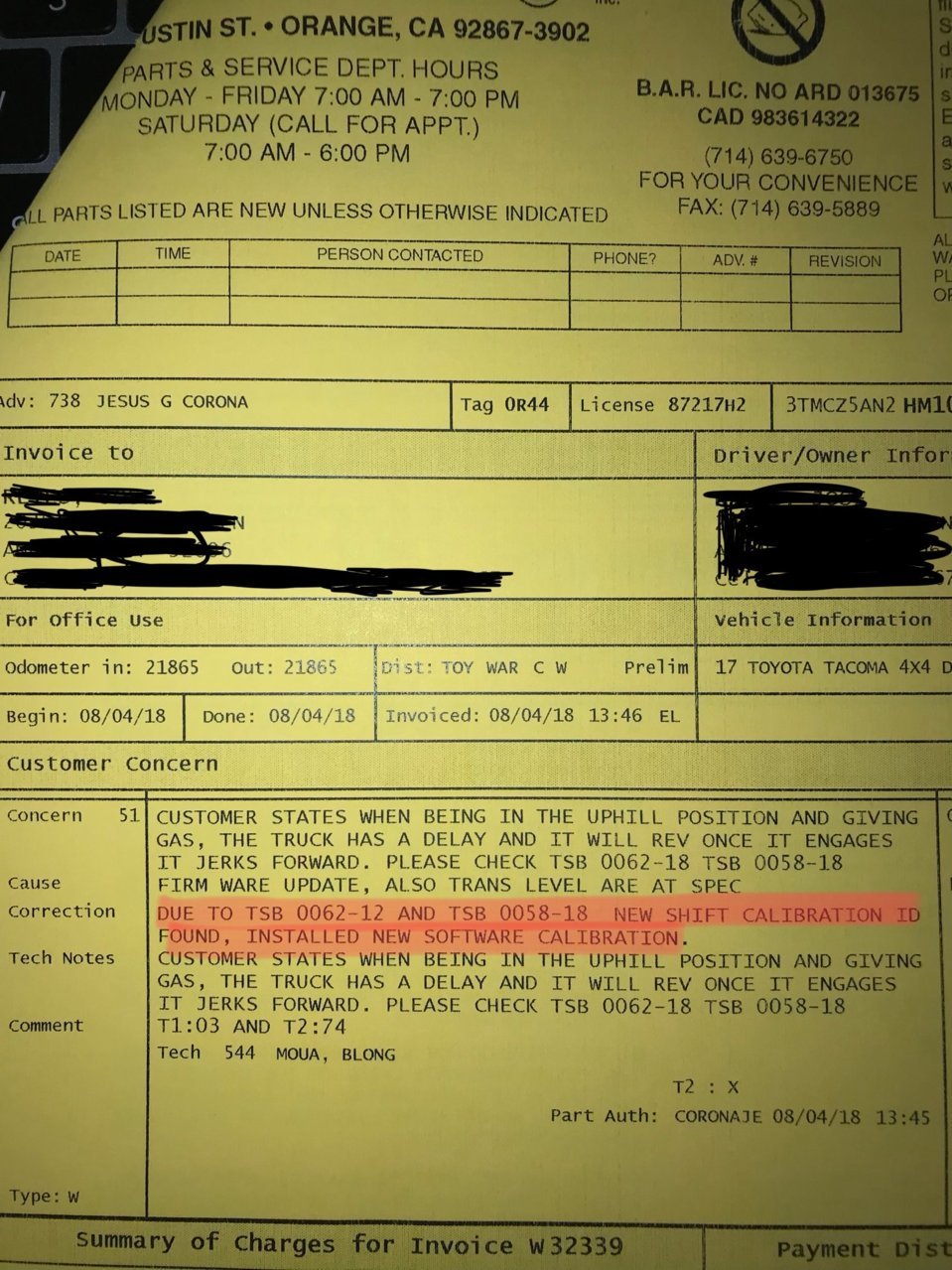

    Went in today with print outs. They tried telling me that I would have to reschedule my appointment for during the week as they were busy and this could take a long time. I told them no and that I didn't mind if they kept the truck the whole day. They told me they will look to see if any TSBs should be performed, as well as, check to make sure the tranny fluid is up to par. If they find out they need to service the transmission, they will have to wait for 6 hours before performing issue to let the tranny cool and that I will have to come back another day for that issue.
    I just picked it up and talked to the service advisor and they told me that they performed both TSBs and checked the tranny fluid and that it was within specs.

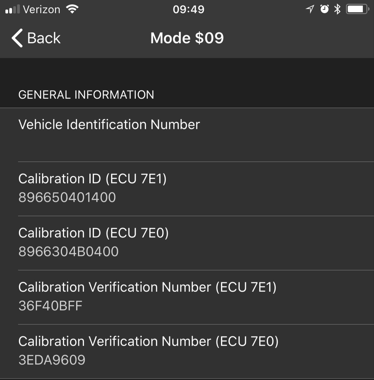

    Just got the update done I think...the service ticket referenced TSB 0077-16. So I went back to see what happened.
    The tech pulled out his laptop and showed me the calibration ID they applied, it matched the one on TSB 0062-18 so I guess they did actually update the correct one and just wrote that old TSB by accident?
    The tech showed me how the system automatically chooses the most current and matching calibration file for your vehicle. And when plugged in to my Tacoma it showed that there was no update available, telling me that they already applied the newest calibration.
    The weird thing is when he pulled up TSB 0062-18 manually and tried to apply that file it said it was incorrect for my vehicle, I wonder if it said that because the most current calibration ID was already applied. (Different tech installed the update initially).

    Do you know which Calibration ID you got when they applied 0077-16? The same thing happened to me today but the calibration matched 0062-18 not 0077-16.

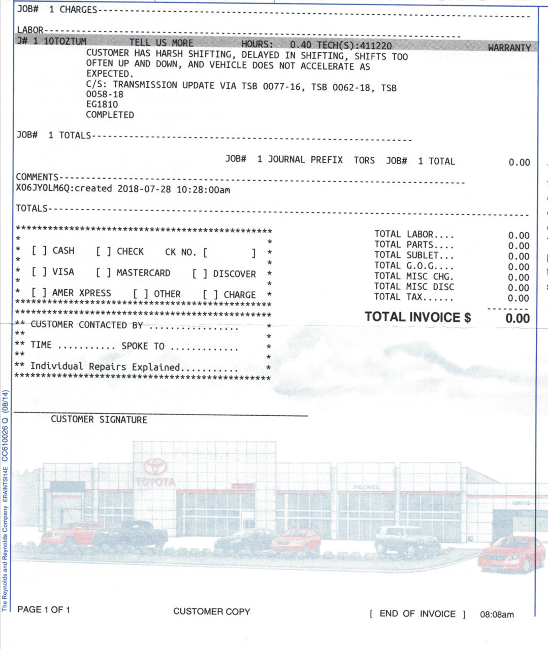

    I have it done yesterday too without any hassle in North central Florida with 3 TSBs (0077-16, 0058-18 and 0062-18)
    And got my new calibration ID
