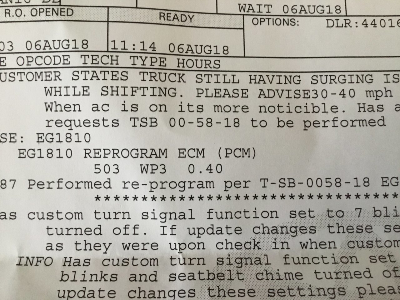

    05E685A8-818C-4513-B2E2-01DBEBB526C2.jpg The one I’ve been waiting for! Drives like it should now and still getting 23 mpg. Stumble is gone and shifts better with more pow! Highly recommended!
