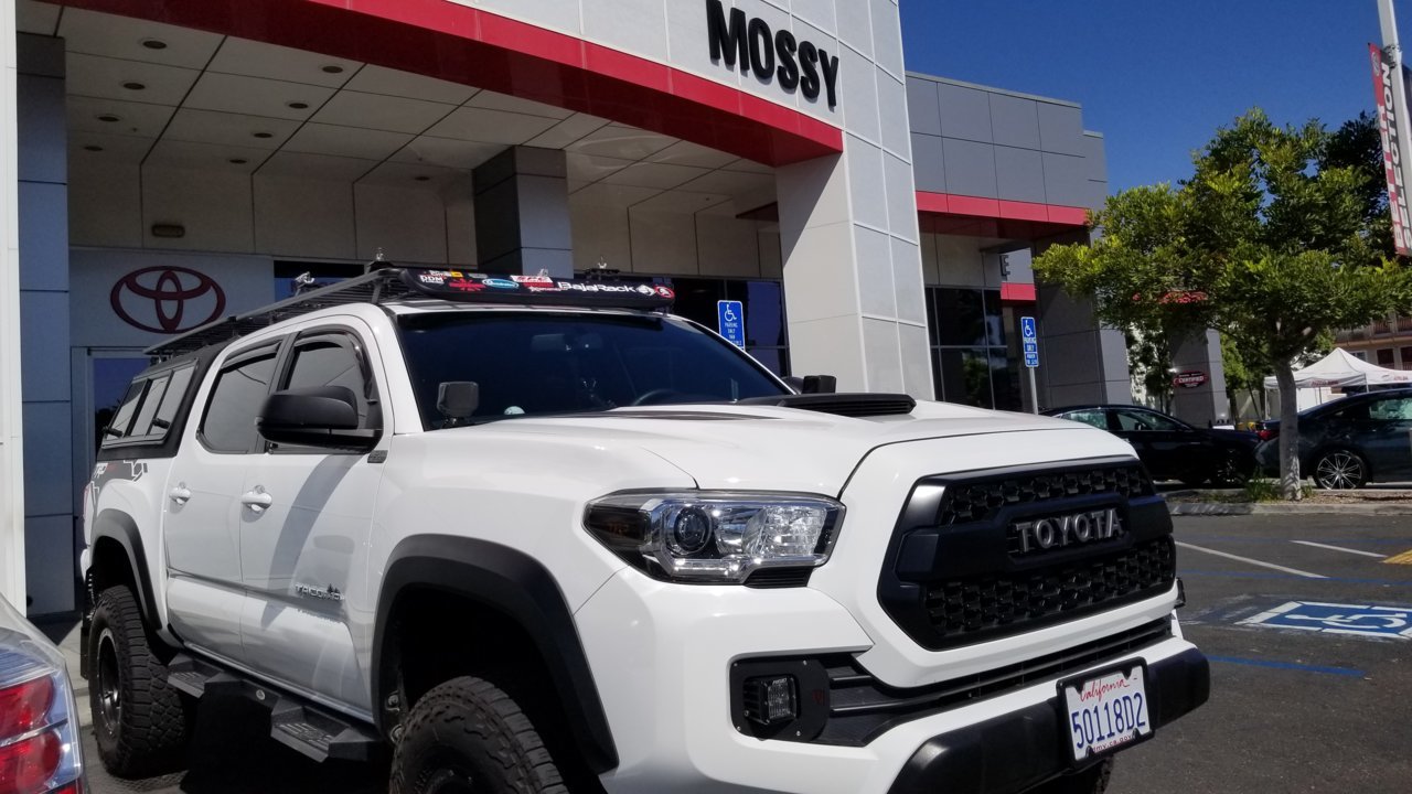

    Just visited my favorite service guys Brian and Alfonso at Mossy Toyota in Pacific Beach California regarding the update. Alfonso was really friendly about it and said there should be no problem whatsoever taking care of it tomorrow when I take the truck in. Every time I go there they're nothing but friendly. Crossing my fingers that I notice a good difference in my transmission. I've run things from the ECT mod to the SSP and honestly I don't think that my transmission is that bad off compared to some of you other fellas. I think to this date it has learned my driving habits pretty well and shifts decently. I also am running the TRD intake and exhaust system. But the way I figure it, it's worth the try to see if the TSB helps make my truck better than it was.
