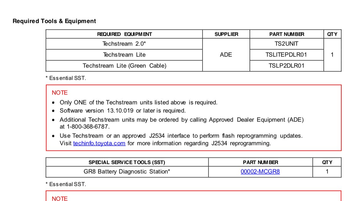

    When mine was done they hooked a battery charger to my battery witch is mentioned on Page 2 under Special Service Tools needed for the TSB. Being yours was done in the parking, this step might have been missed.

    There’s absolutely no need to use a battery charger during the process. Turn off the headlights, A/C and radio, and you won’t run the battery voltage down during the 10 minutes it takes to flash the update.

    Ok. Good for your 25 year tech. Thousands of trucks tuned with Orange Virus, using the exact same process, have been done in their driveway, without a battery charger hooked up, and run fine.
