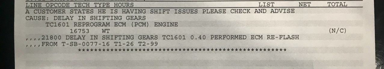

    '17
    So did I get it? I can’t tell by reading this print out. My drive home was short and flat, but it felt somewhat quicker.

    2024 Tundra Plat 4x4 LB (prev 2018 DCLB SR5 4x4 and 1996 AC LX 4x4 5sp)
    Looks like you got the old transmission TSB to me. T-SB-0077-16. I could be wrong. Someone else will chime in.

    '17
    I was hoping it meant I upgraded to 0062-18 from 0077-16. Dammit, I handed my service advisor a Post-it note "Give me TSB-0062-18".

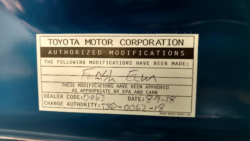

    1,662
    Northern California
    2018 Blazing Blue Pearl SR5 DCSB
    This is what you guys should see under your hood after the TSB. IMG_20180810_164241019_HDR-800x450.jpg
    I didn’t get that. But eh no big deal.
