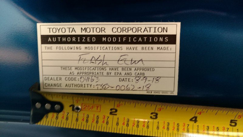

    Sure would be nice to get a photo of this squared to the camera and with a ruler beside the sticker, just saying.

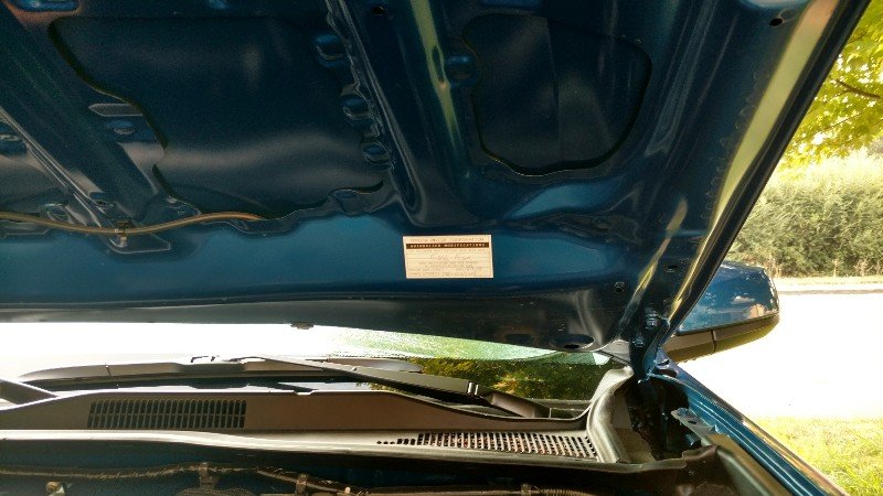

    Ask and ye shall receive. Good as it gets doing it one handed. IMG_20180810_183637951_HDR-800x450.jpg IMG_20180810_183735971-800x450.jpg. Sticker is a little smaller than the Emissions Sticker.
