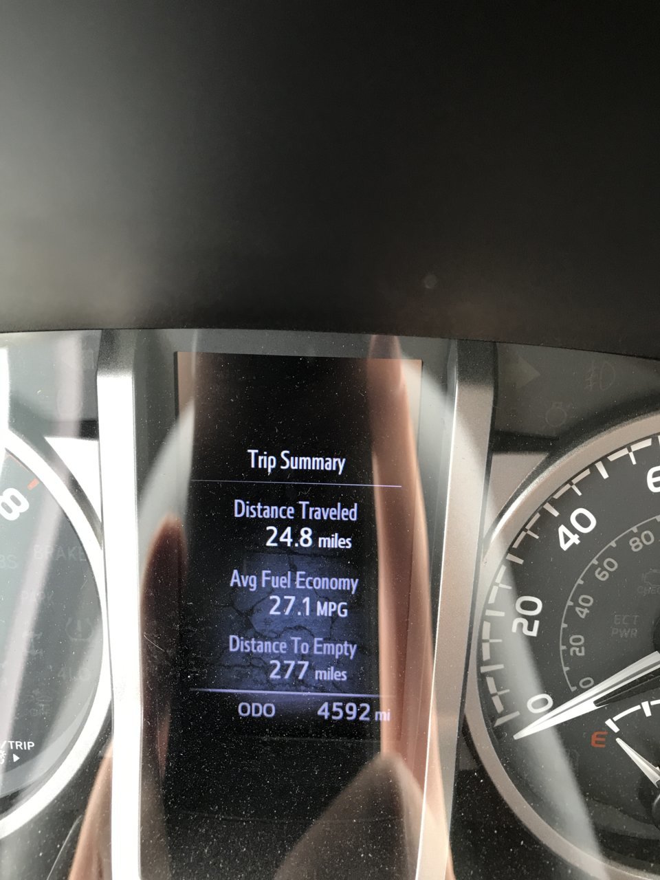

    Well, took a trip to the Leathermans store to use my friends and family pass today. It’s located up by PDX in Portland. Even on a Saturday morning there was stop and go traffic in parts... hate that city, but got a new multi tool and headlamp for cheap! Haha
    Anyways, below is what my screen said once there:
    I know it’s only a few miles, but still pretty solid for some hills and traffic.
    My way back I got 24.5 and I was way harder on it (also way more traffic..). Shifting is very smooth once the truck is warmed up. Truck now will downshift and hold that gear going up a hill. No more shifting up midway up a hill as soon as it sniffs a slight decrease in the climb... This update feels like it’s a mild ECT button. Which is good! Didn’t notice any weird engine braking like yesterday either.
