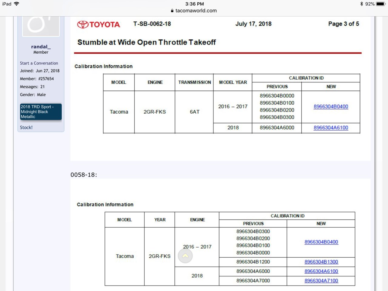

    Downloaded OBD Fusion and was able to finally figure out where to look for the calibration IDs. I don't know why there are two IDs but at least I know that the update was indeed performed. My dealer didn't put the sticker under the hood so I had some doubt (haven't been able to fully drive/test the change). This settled my OCD.
    BTW I have an 18, so mine would end in 6100
    Rodchester[QUOTED] likes this.

    I used Car Scanner. Shows at the bottom of the opening page.

    found this a few hundred pages back.. but not sure it is for the WOT problem.. im going to check my 18' via code reader to see if it possibly has the update already done... but if any canucks here have more info please share!!

    so where do you look on the obd fusion?

    I didn't really know where to look at first. Poked around a bit and found it in the MONITORS section under the MODE$09 subsection..... IIRC
