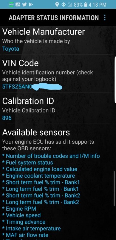

    Trying to confirm calibration number with Carista and Torque Pro. After a twenty minute ride, this is all I'm getting under the adapter status button. I've poked around and can't seem to pull it up elsewhere.
    Anyone using Torque Pro have any advice?
    Tkx in advance.

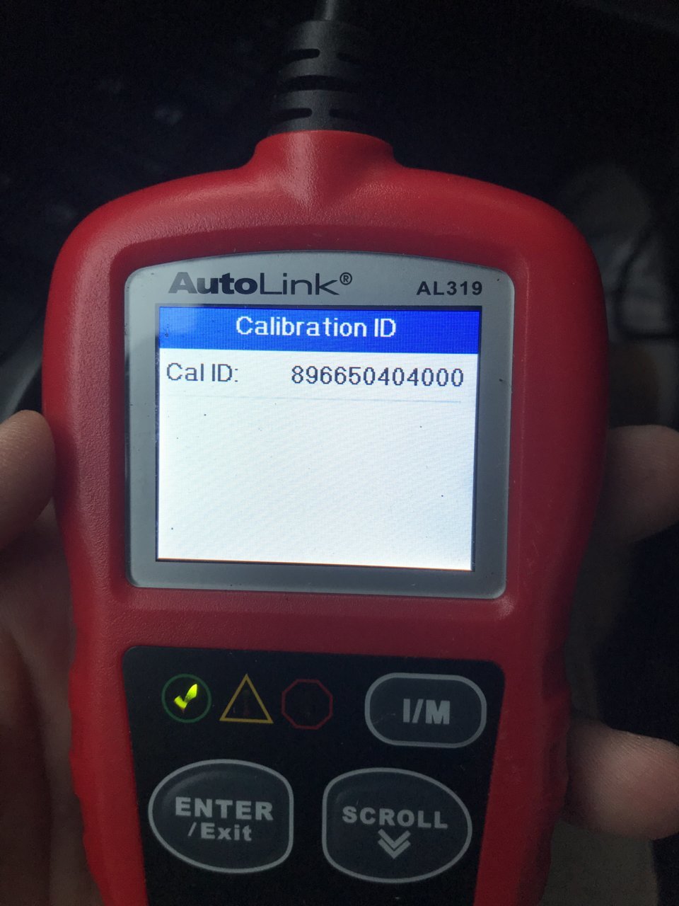

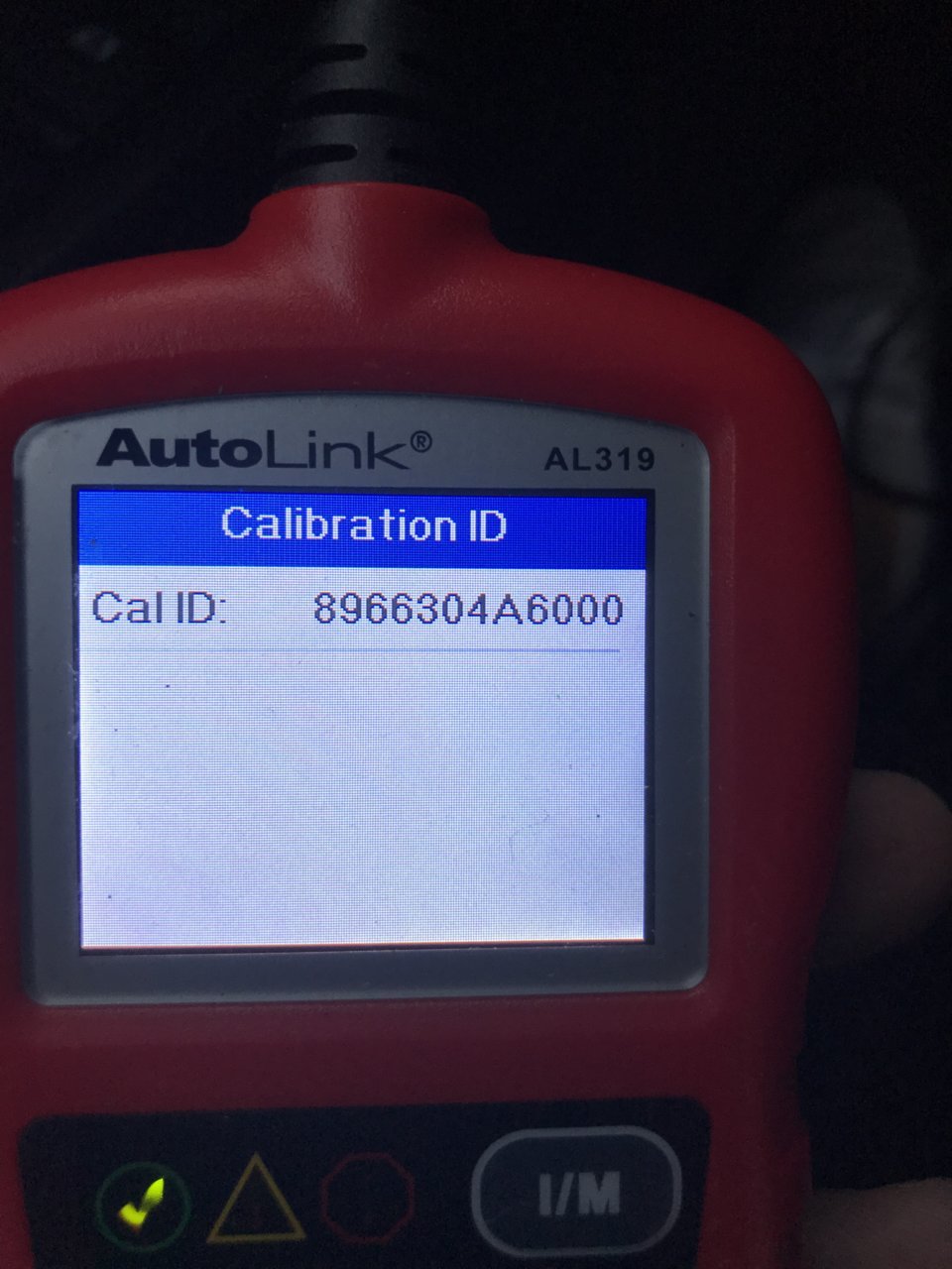

    2018 AFTER having the TSB-0062-18 done.
    This is what the Cal ID's read BEFORE getting it done.
    HIGHLY RECOMMEND THIS UPDATE!
    oscolivar1 likes this.
