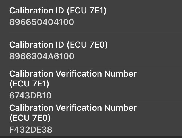

    I just verifiied (with my scan tool) the update was loaded in my ecm. I got the B0400 version.Ill update in a few days.The shifting has changed.Only driven 15 miles so far plus the computer needs to relearn my driving habits,I believe.

    Edit:
    Brand new 2018 TRD Off Road Double Cab long bed.
    I used a OBDII Bluetooth device I got back in 2015 and installed the OBD Fusion app as suggested in this thread.
    Amazon
    "BAFX Products Bluetooth Diagnostic OBDII Reader/Scanner for Android Devices"
    I used the pic from a couple pages back and have the same info after reading the MODE $09 in OBD Fusion.
    The app is 3.99 on Play Store, at least I know I got the 0062-18 update!
    Truck is running a lot better, amazing the difference.
