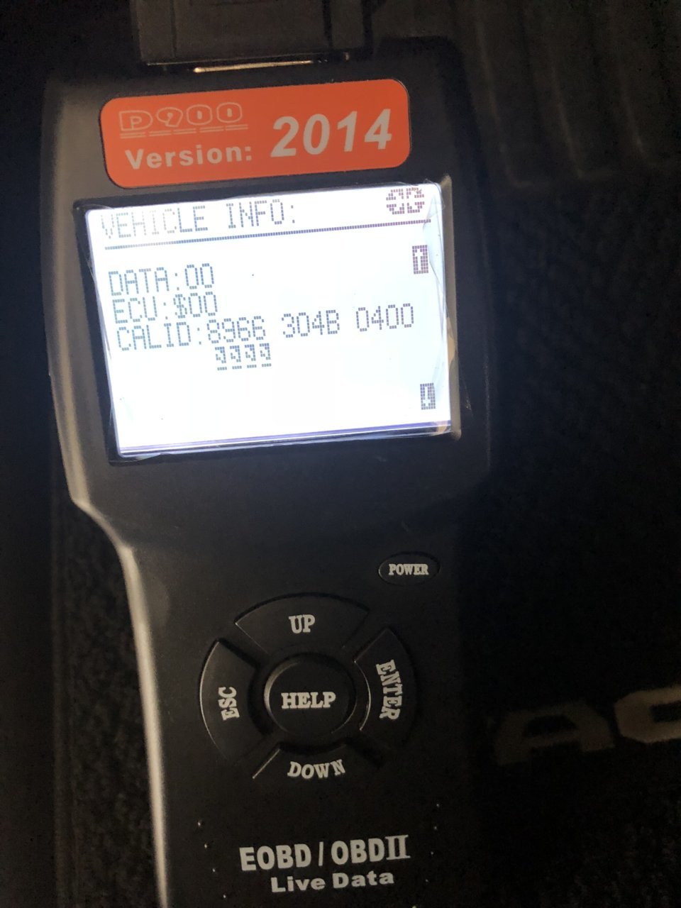

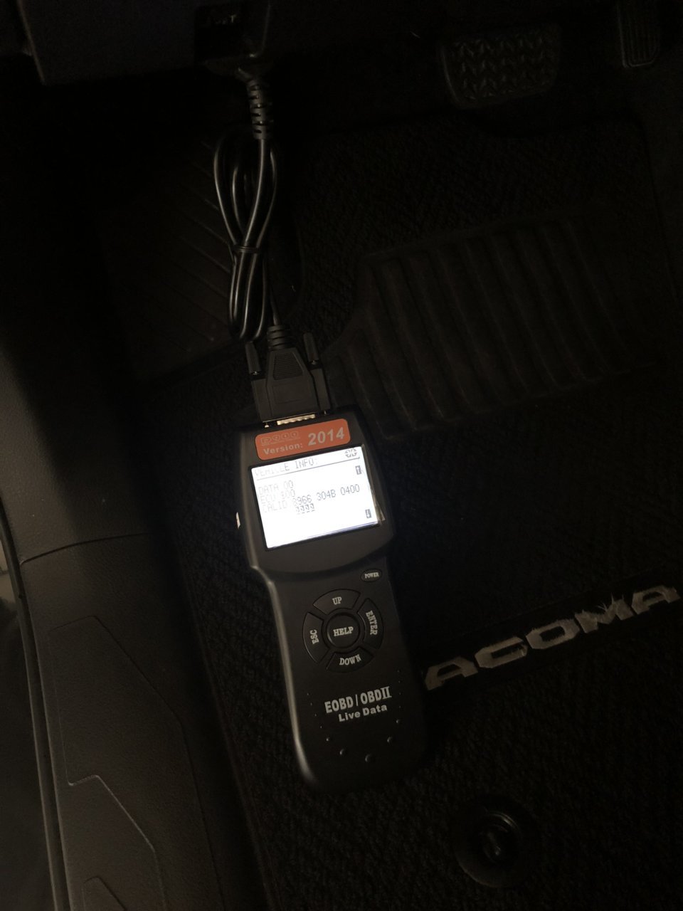

    Seems like a few people including myself had the 77-16 tsb noted on our service tickets but may have actually gotten the b0400 (for 2017 models) calibration. I verified I did so not sure why they are noting the old tsb.
    Like I mentioned in a previous post, the Tech showed me their software always installs the latest calibration id available and isn't capable of flashing an older one since it checks directly from Toyota's servers. I seen it myself.
    Might be best to verify with an obd reader for piece of mind though.

    Just curious, what do you use to check version? You mention its an OBD reader but is it a phone app or on your computer?

    2016 Black TRD Sport, Tuned, BHLM OEM LEDs
    GTS Dobinson's lift, 33"-Wildpeak Atw3-18x9 -6 Offset ,265/70/18 tires, Raceline Assault wheels, Backflip G2 bed cover, Magnaflow exhaust, Pro tail lights, Pro fog lights, Pro grille, Raptor grille lights, Predator side steps, RedLine Hood Struts, Toyota bedmat, tinted windows, Retrofitted-BHLM-Amber Halo-Amber DRL-HID headlights, LED Highbeams, LED Hood Scoop lightbar, LED hidden bumper lightbar, LED under hood light, LED Bed lights, LED license plate lights, Tacoma tailgate 3d letters, Tacoma glovebox 3D letters, removed air dam, Custom TRD Sport emblems, Pro Shift Knob with Meso ECT Stealth button, Meso LED dome and map lights, Meso V3 smoked mirror turn signals, Meso Stage 2 Tail lights, Meso Mirror Puddle lights, Meso KC-5 Brake/Cargo light, Meso center console bucket with OG lid, Tailgate PNP kit, Garage door opener button in overhead console, Meso Minimalist keyfobs, Matte black Pro hood decal, KTJO4x4 Led door handle LED lights, Pioneer 6x9 3 way front speakers, Rockford Fosgate 6.75' rear speakers, TacoTunes tweeters, AJT black vent rings, JDM Gas cap cover.
    Just this one I had bought a few years back on Amazon.
