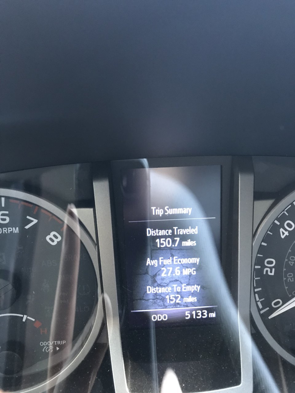

    Did a 330 mile round trip today into the Cascades. Went from 150ft elevation to about 5,000ft and back down. Lots and lots of hills. Kept it in drive the entire way there. Still some delay in down shifting once hitting a hill, but better than pre TSB. The truck definitely loves to hold a gear on hills now though. I had one section on the way up the pass that it dropped to 3rd and would not let go ha I sped up and slowed down and it still kept it until I crested the hill. 4th would have been just fine, but eh. No traffic on the way there so that was great. 23.5mpg when I pulled into Wizard Falls.
    The way back went a little differently. I had to use sport mode and ect pwr to get back up the pass. This was mainly due to having to pass traffic. 4th just didn’t have it at elevation. I only had me and the fiancé in the truck and no gear really. Stock tires. I had to drop to 3rd gear to keep up with a frontier on 35’s on one steep part of the pass. He had to have his foot through floor cuz he was movin lol
    Maybe it was due to the heat, but I hit 3rd and 4th on downshifts quite a bit on our way back. Acted more like it’s pre TSB self, but the cascades aren’t exactly flat lol Just kind of surprised me as I was dropping a lot of elevation between these inclines.
    No surprise my MPG was great on the way home.

    looks good- what do you think your mileage would have been before for that same leg of that trip shown in your odometer?

    Hmm honestly it’s hard to say, but I would think a little worse. Once it downshifts on hills it holds that gear now until you actually crest the hill. Pre TSB it would shift back up as soon as it sniffed a tiny decrease in steepness on the hill. That would happen when the climb was not close to being over ha So how it is now should give me better mpgs in the hills. The only time today I think it hurt mpgs was when it locked in 3rd on a hill when 4th would have been fine. It was a long climb so it held 3rd for a while.
