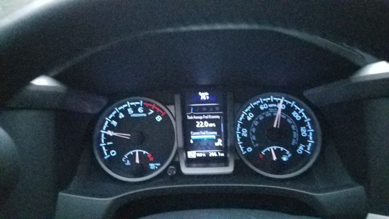

    This morning I got TSB 005818 done at 10K service.
    1st of all, my truck was driving good most of the time. Great millage even in bumper-to bumper traffic, no gear hunting, smooth shifting.
    But I had a few annoying things like "clunk", dead pedal, jerking between 40-50 mph, RPMs will not drop immediately after releasing pedal.
    All these are gone now.
    Right after the service I took truck east on I-90. You can hear changes in noise of the exhaust going up the hill, truck is not laboring anymore. Now I can feel the "wire" between pedal and throttle.
    I'm excited.
