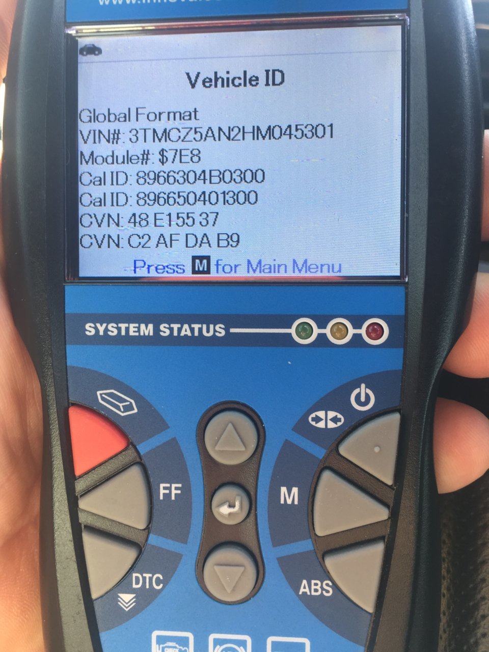

    going to be fun!
    0010AD4B-32F4-4683-80A3-FA6CB2ADE31E.jpg I think I need the update....

    What Apple phone app are you guys using to view the calibration ID?
