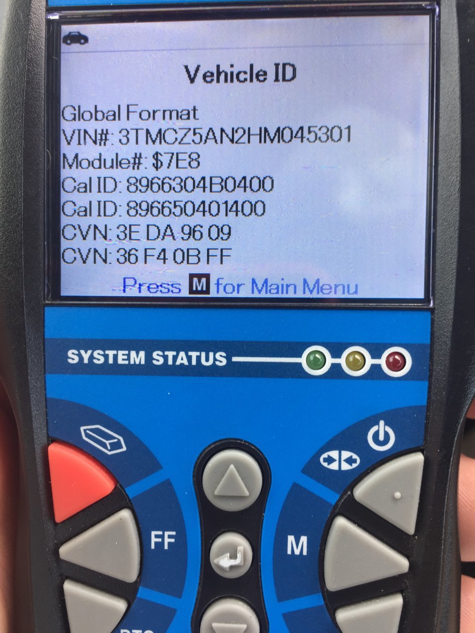

    I finally validated that I have the correct calibration!
    Both Calibration ID’s end in 400.

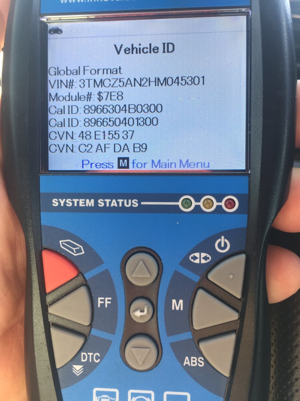

    I printed out the TSB. Dealership said they applied the updated. But it still drives the same. Hopefully the next dealership will know how to.
    RobP62 likes this.
  17. Aug 25, 2018 at 8:10 PM
    #1117
    tcjacado
    tcjacado Well-Known Member
    Aug 29, 2016
    #195947
    41,586
    Find a local member or auto parts store with a code reader and confirm that way.
    RobP62 and Tig3r_Bit[QUOTED] like this.
