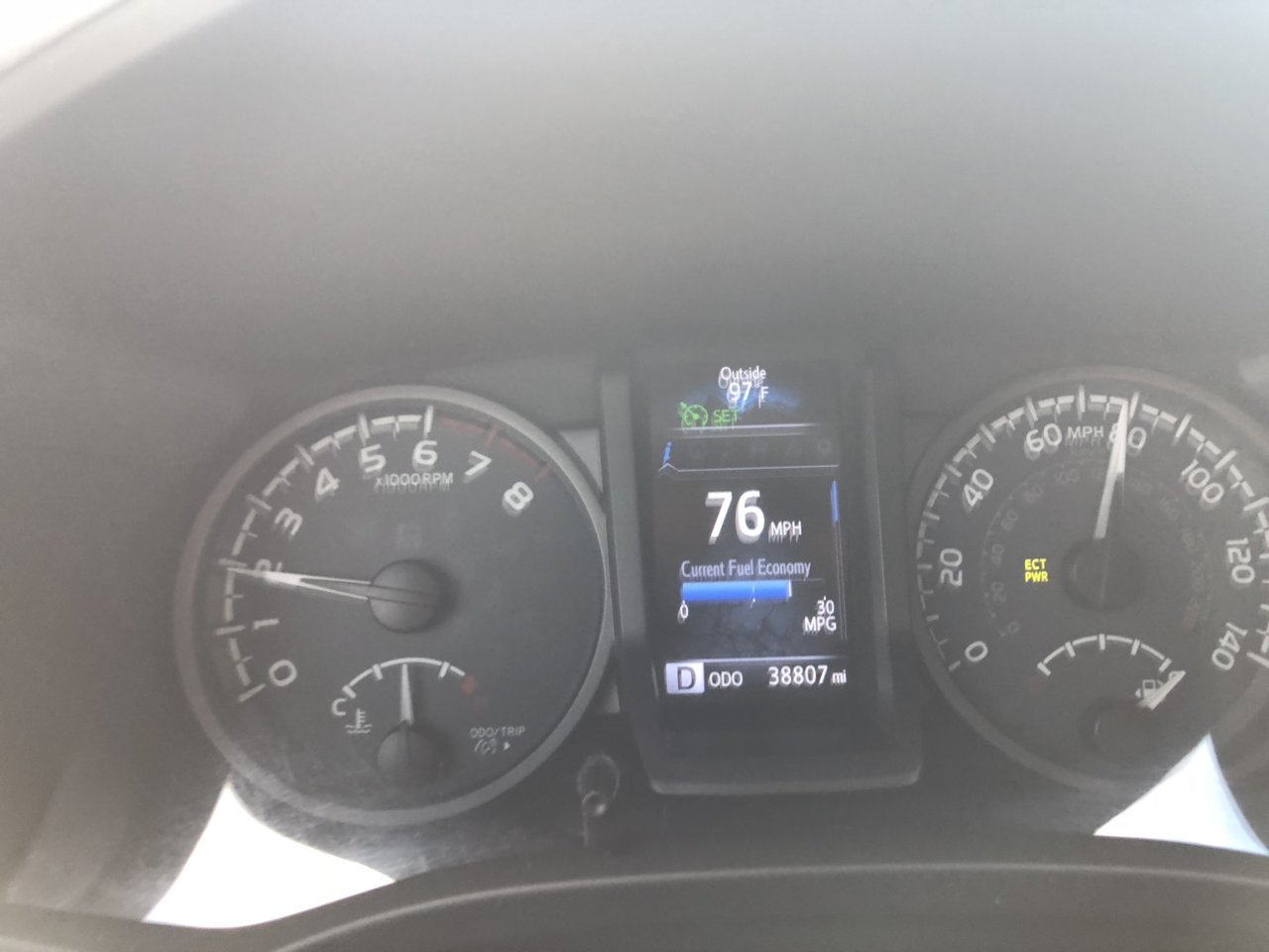

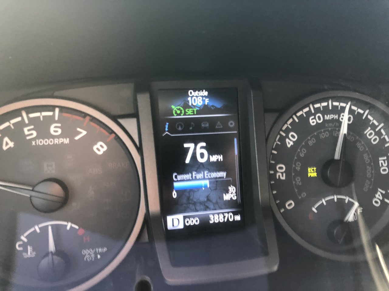

    I’m lifted on 33’s and was averaging max 17 mpg. Here’s a pic after TSB.
    Prior to the TSB I wouldve been at 15 doing this speed.
    Note the OAT differences in the pics and corresponding mpg

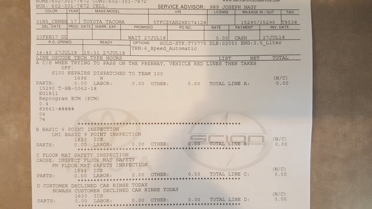

    At the dealer waiting for TSB 0062-18.
    For the 6 miles I drove from the dealer to home, it feels like truck has a bit more gitty-up. Before the gears were changed at around 3000 RPMs, now it holds a bit longer close to 4000 RPMs before it shifts.
