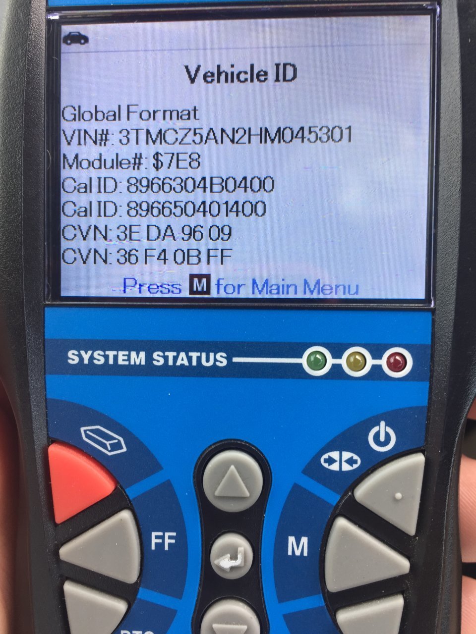

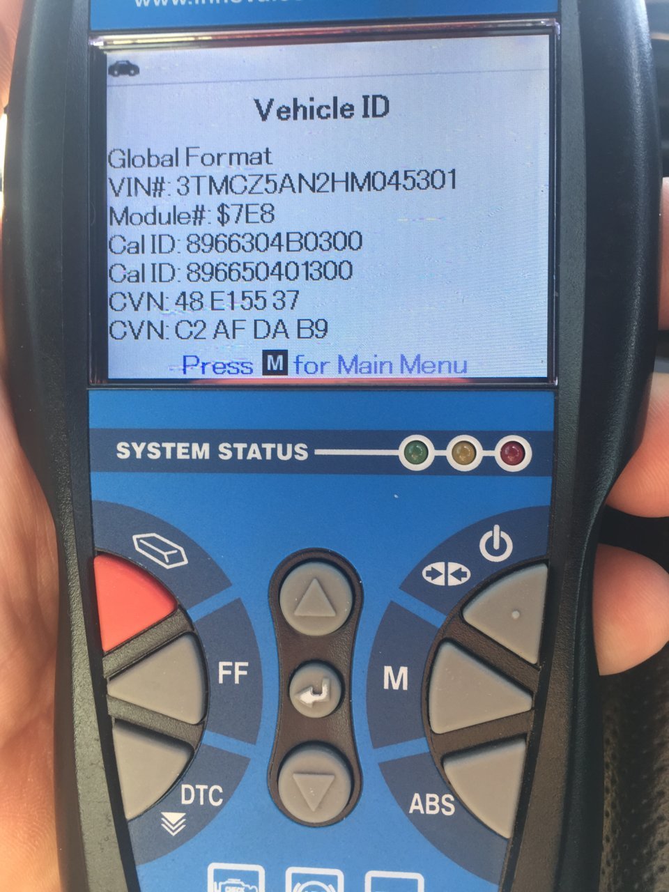

    This morning I took my truck to the local dealership with both TSB's in hand; 0058-18 & 0062-18. I explained that the TSB's detail perfectly the problems I've had with the truck from day 1. The service writer say, "No problem, I'll have my tech update the ECM for you right now". 30 mins later, the truck is finished. The invoice shows EG1810 Reprogrammed ECM (PCM)
    I pull out of the parking lot and start my 9 mile drive home. Immediately, I noticed the shifts points have been changed and changed for the better. The truck holds all gears a bit longer, not so eager to get to the higher gears as soon as possible. The up and down shifts are silky smooth, zero shift-shock. Prior to the update, it would take a good 40% of the gas peddle to get a downshift. Now, with only a tiny bit of pressure on the gas peddle I get a seamless, instant downshift to the correct gear. The surging and bucking feeling at 42-45 mph is gone. In my opinion, it seems the transmission now operates in half power mode. All-in-all I'm very happy with the update and the transmission is far less confused than prior to the update.
    If anyone is in the Ft. Lauderdale area go see Service Writer Mike Zaremby at Deerfield Toyota, no questions asked, fixed in less than 30 mins.
