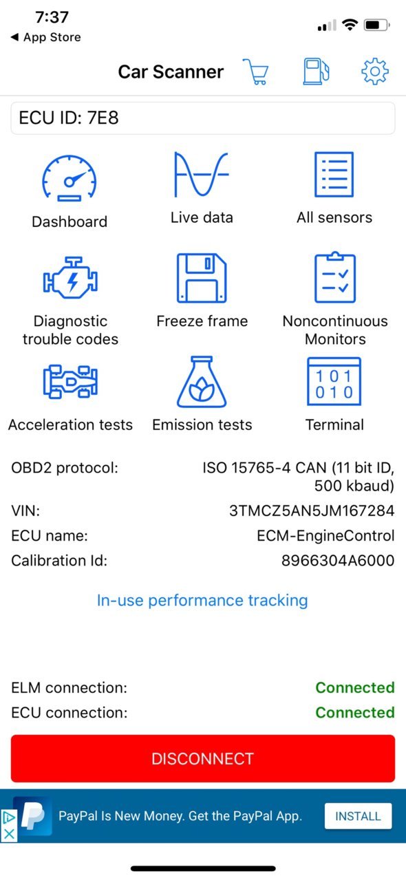

    Correct, should be 8966304A6100.

    I don’t think that’s right. It should end in “B0400”.

    If your current is 6000, the update is 6100.

    I stand corrected that is for the 2018 model, so no issues. 2016/17 is as I noted.
