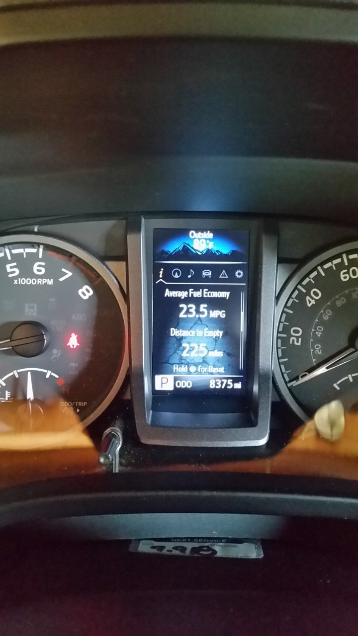

    763E3E1B-8033-40D1-BF8C-510D2C61E95D.jpg Put a few hundred miles on since up date and I gained a half mile to the gallon!
    Crimson Flam3s and remgu2000 like this.

    shit mine has only seen 22mpg a couple times in 10K. only have about 10 miles on it since the tsb.
