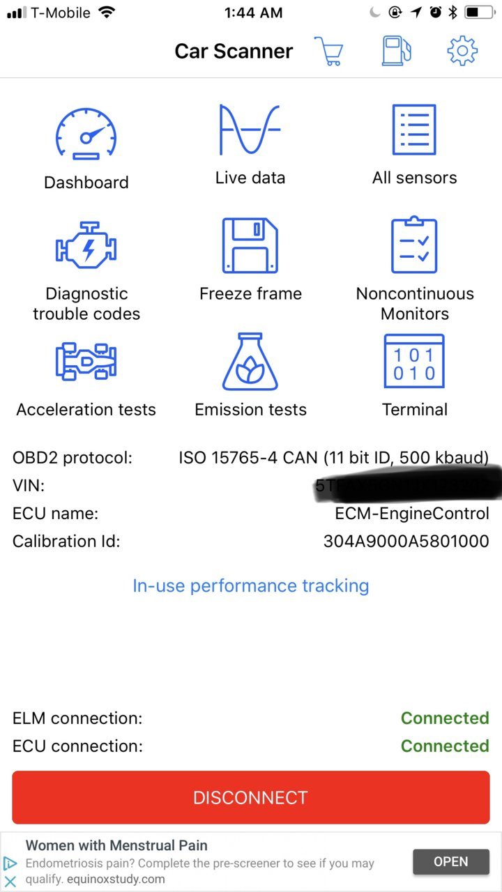

    I bought my truck last month. Today I bring it to dealer. They said that my Tsb is lasted version. I have OBDII using Dash Cmd connect to Iphone via Wifi but don't know how to check it. Can some one sharing the experience to check? Apreaciate that..

    Try using the Car Scanner app. Get it to connect. The info will show up near the bottom of the first page(if I remember right)

    I have the calibration ID from Car Scanner but the format is look like different with the normal one which begin with 86xxx.. By the way my truck is i2.7.. it's not V6 and someone in this topic said that this update version not for i2.7.
