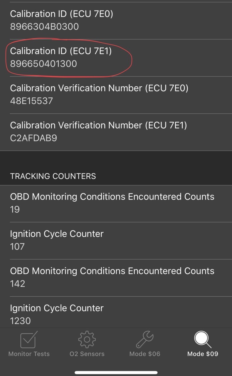

    Yeah, yours is different being a 4 banger, but the cal. ID is where it would show up.

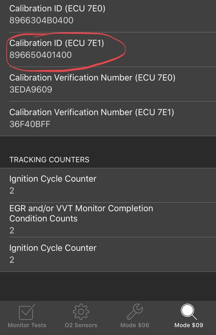

    Boom! No sweat from the dealer. Before and after. 3696B221-F344-4139-97DD-C1D2F420548D.jpg
    RobP62 likes this.
