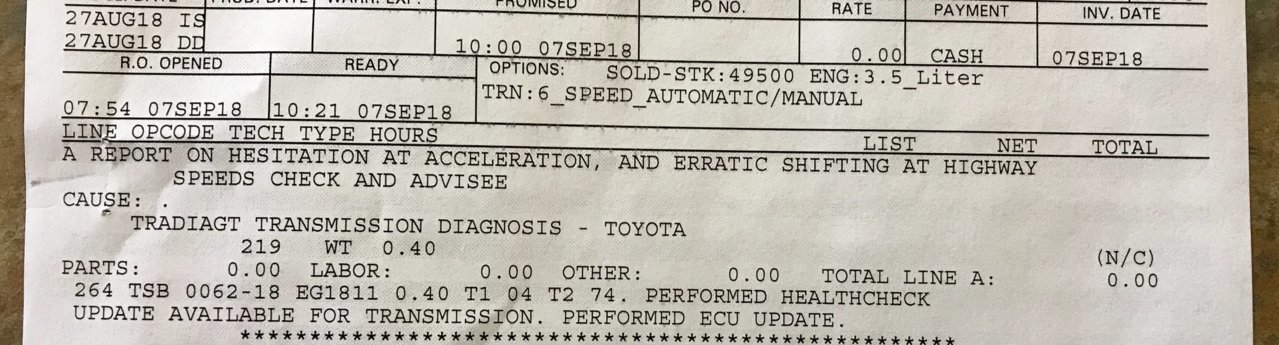

    Got my truck done today, dealer knew about this problem and got it done. The ride home was great. BTW mine is a 2018 model year.

    I'd call BS on the dealership. Find and print out t-sb-0077-16 and t-sb-0058-18r1 then reference the calibration information previous and new column. It's clear to see 0077 is the old cal. Id.

    Got the TSB 0062-18 done today. I have a 2018 OR. I don’t need the TSB 0058 correct?

    You are welcome. 58 and 62 are the exact same update. I hope it helps!
