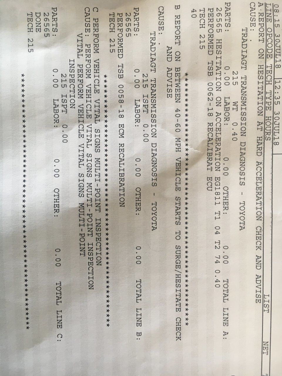

    Got both TSBs. Very happy with the short drive home. I love my dealership and service advisor. No hassles. No fuss.877489D9-6638-46CA-8A74-93174B91C3F4.jpg

    #165572
    1,987
    Ont. Canada
    2016 Grey Tacoma sport dc long bed
    Can we see your service repair sheet? Itll say on there
