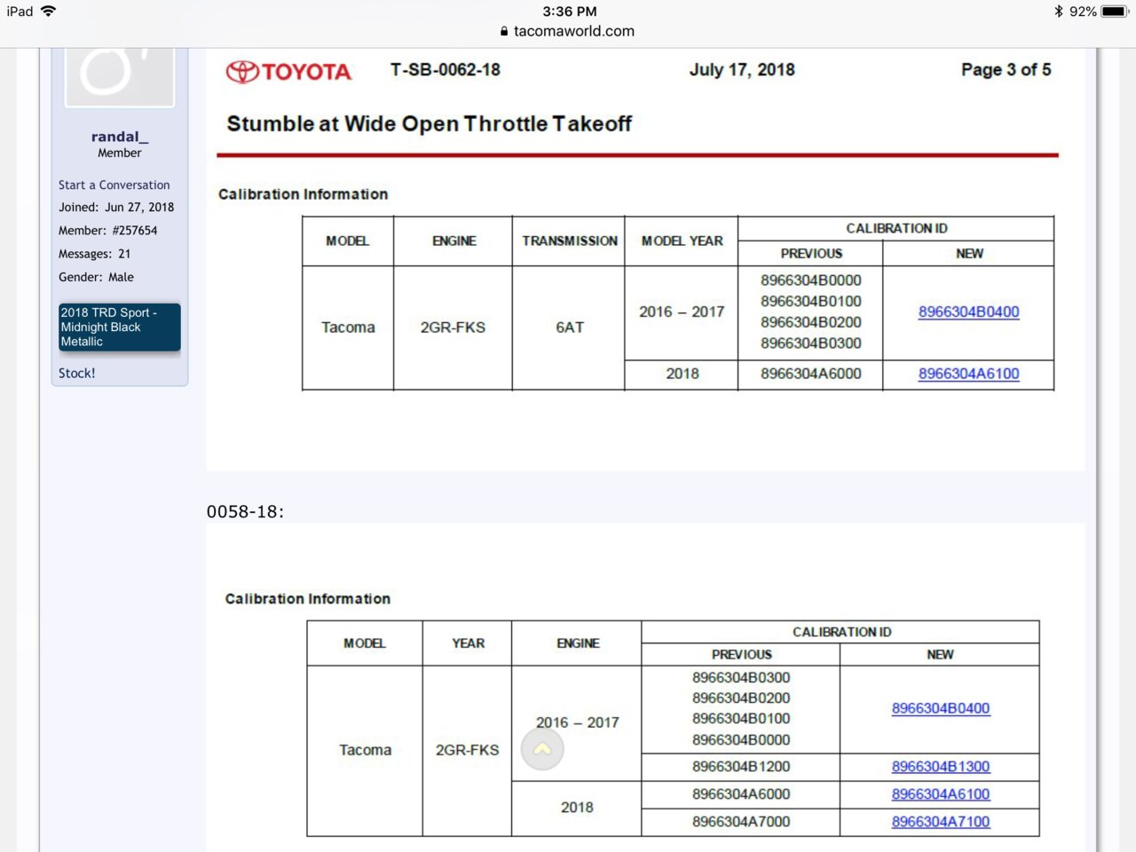

    Its almost certainly not done. Mine is a July '18 build and it was not done. Check your calID with an OBDII scanner, compare to that noted on the TSBs in this thread, just a few posts back. Most new vehicles shift a lot as mileage is more of a priority, but this thing was ridiculous.

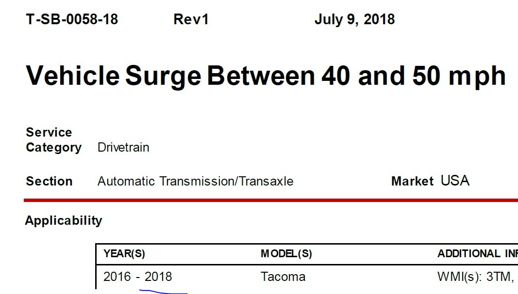

    Took mine (2017 Sport DCLB) in for 10k service last week... Trying to figure out what exactly they did - hoping someone can help me out. Brought in three TSB sheets (58, 62, and one for the squeaky leaf spring issue - mine is really bad and I can hear it while driving with windows up!). No questions asked about shifting, etc. aside from what I told them about when I set up the appointment and had non-10k service issues to address. They called later and said everything was done, so I went to pick it up and saw the printout/ heard from the rep. They did an ECM reprogram according to TSB - 0077-16. A little research shows this to be a reprogram for shifting issues for early 2016's, and I have no idea if there are updated revision, or if the re-program is the same as the two TSB's mentioned on here and what I left with them. Haven't had a chance to drive it a bunch, but it did seem to help the main problem I experienced, which was really jerky shifting when coming off a "coast" under about 30 mph. Really noticed this issue when rolling a stop sign or similar and getting back on the gas, it would really jerk, instead of a smooth movement back into acceleration. But I'm curious if this reprogram addresses the other issues. Could they be dumb/ bad enough to reprogram the ecu with an out of date program?? How can I tell what they actually did with my ECU reprogram?

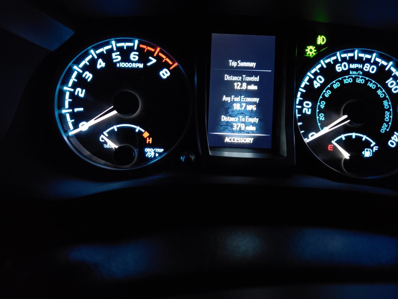

    Where are you seeing trip average?

    Anyone know if the Carista obdii thing will show the cal ID?

    I'm
    Not seeing a screen like yours. Is it because I'm in an '18? Mine doesn't have the individual trip info. Nor does it say "accessory" at the bottom. Hmm.
    Mine just has a "tank average".

    You can use the carista obd2 with the car scanner app to see the id.
    There's a settings option on one of the screens that allows you to change up what shows up on each scroll screen.
    Edit: also, I think that screenshot is the same screen that shows up when you turn off the truck after a trip.

    It's one of the data points that are configurable on the three screen display. It's the average mpg from the last start. That said mileage on the way home, which is more uphill, was 21.7.

    Use this button and press the down arrow once if you are at the screen that shows your speed digitally.

    Yep I did that but don't get the same info.
