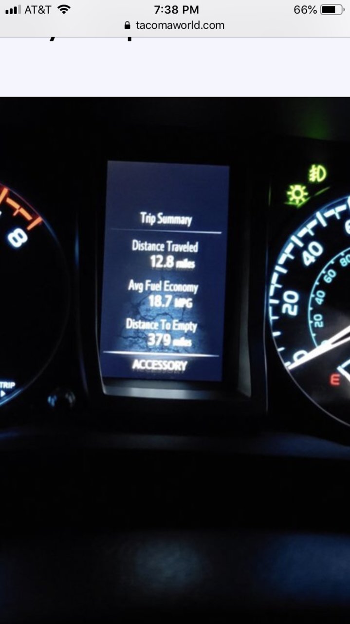

    I can't find this individual trip data.

    When you turn the truck off it will show the trip average. It will stay on the screen until you open your door.

    ^^^yes, he is correct. This only shows when you park and shut the truck down. My bad.
