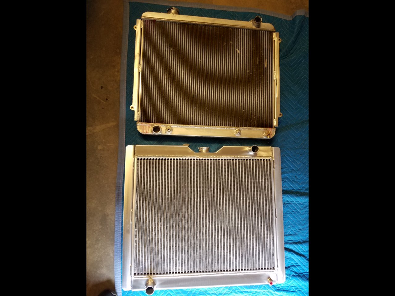

    The champion radiator construction is just not a good design.
    It will crack sooner or later. The header tank and lower tank and core are not welded together as a solid frame and because of this any flex will create a crack inbetween the core and tanks unlike a solid frame.
    You can look at the top Champion radiator compared to the custom bottom radiator for the Tacoma

    Link to the better, bottom one?

    It was a custom radiator made with an extruded interior design for max performance.
    The aluminum is probably 3 times as thick as the Champion,
    If I remember the customer radiator is like 35 pounds and the Champion is maybe 10 or 15 don’t quite remember.
    Was 1100.00, expensive but will be the last radiator I will ever buy and keeps my temperatures at 170-180 all the time regardless
    https://m.youtube.com/watch?v=8_-5ys9PapU

    Yup, you pay for what you get, you might want to just get the Champion radiator then for 200.00.
    Mine lasted 30-40k
