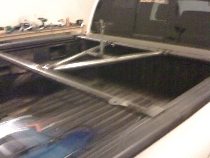

    I like it. That design is catching on.

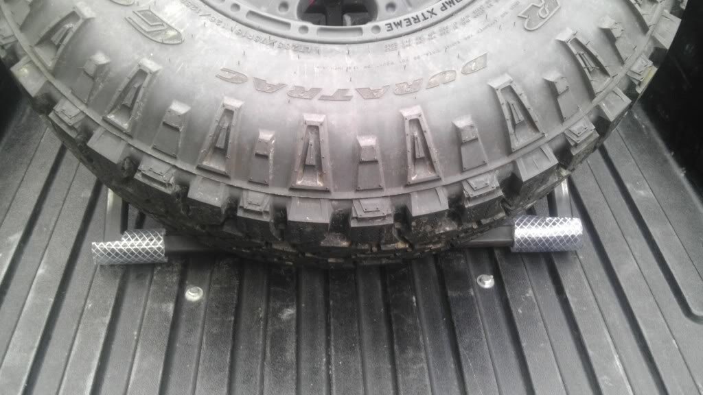

    I built mine a couple of months ago. When the tire is down, I slide the second bar up against it to hold the carrier in the down position.
    I like the way you're bolting the tire to the carrier. I originally made a wedge shaped screw that I would screw in place. Figured out pretty quickly that would tear up the wheel. So I made a plate that falls into place in the wheel and is held down by a T handle, screwed in place. That is working well, but I like your bolting it down idea a lot. More secure, especially against theft.

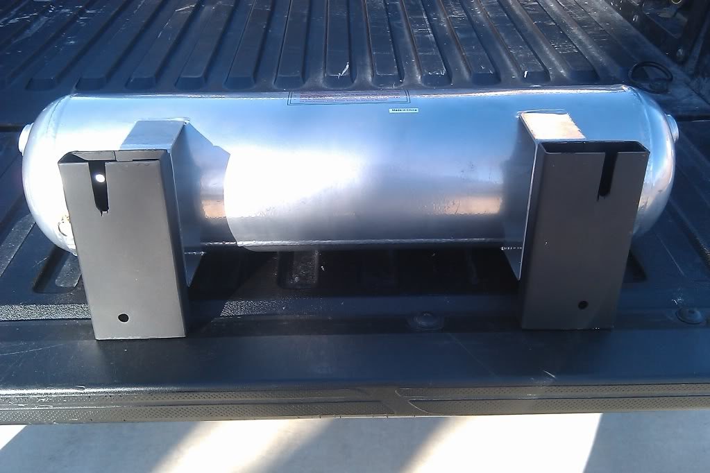

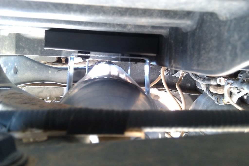

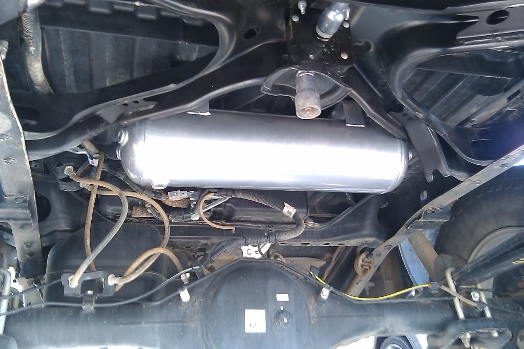

    I got 'em at Northern Tool. I'm gonna use them for the lid on my M416 when I get around to building it. I'll see if i can find a link to them. Im on my phone and it just goes to their mobile site.
    Thanks, just 2 bolts on the hinges and it's completey out.
    The bolts are holding the air tank. I put in D-rings in the front corners and I have it ratchet strapped down. Since it's so heavy it may be enough to hold it down. If not I'll use some turnbuckles. Next week is vacation and we are wheelin/camping for 4 days so I'll see how well it works.

    I seen your thread when you built it and commented that I was gonna build a similar one soon, just took me longer than I expected! I've been building this in my head for 5 months or so, and it's changed a lot! When i seen yours I realized I was way over thinking it! How is yours holding up? Thinking of changing anything other than the mount it self?
    Dooo iiittttt!!! :D If you want some measurments I'll gladly share.

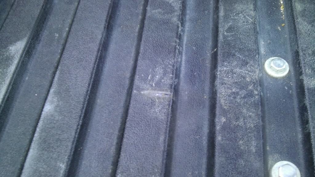

    An update to this also, it was rubbing into the bed at the corners of the frame. The ratchet strap holds it down just fine but I think it vibrates just enough to cause it. I used some tubing that I had to stop it. It sure ain't pretty but it works! If we had a bed mat it wouldn't be an issue so I guess that's on the list of things to get now!
    We took the truck on a 4 day camping/wheeling vacation and it held up great!

    I used this hinge http://www.northerntool.com/shop/too...6307_200306307 and I got 20' of 1"x1"x1/8" tubing, around 6' of 1 1/2" angle and various nuts and bolts. The box is 24 1/4" by 30 1/2" and the top of the T is 5 1/2". I don't have the wheel sitting on the T, the bolts are squeezing the tire to the frame. For the rubber bushings holding the tire on I used a bump stop out of an old shock I had laying around. Your size may be different if your wheels are bigger or a different offset. I took the back rail off and replaced it with the angle.
