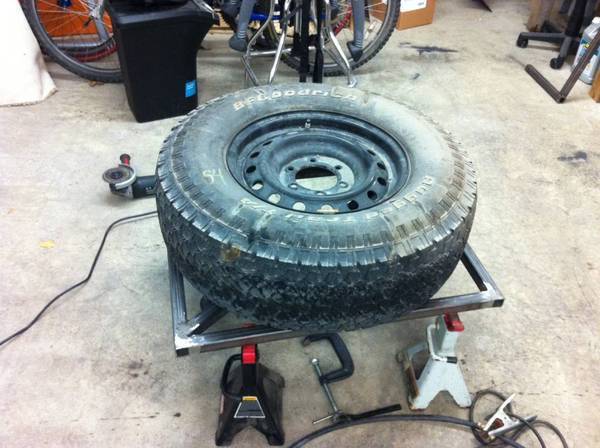

    Just finished up most of the box last night. Did a diagonal cross member instead of the T type you used...well see how it works. Still gotta weld up the angle iron, T tire holder and such but it's looking good. So glad I'm doing this....getting the spare off simply to measure last night was such a pain....but def getting it powdercoated!

    What ya think?
    I haven't cleaned up the welds in their entirety quite yet. I still have some work to do on the grinding, and need to add the T section in the middle. I was going to do a full X pattern, but I kept messing up the smaller pieces and honestly...at this point with the steel I/we/you used...I could hold my truck up with this thing its so solid, ha!! After this I have a guy whos going to powdercoat it for me...I'll post pics when its totally painted. The really cool part is my friend is teaching me how to weld so I'm learning a new skillz at the same

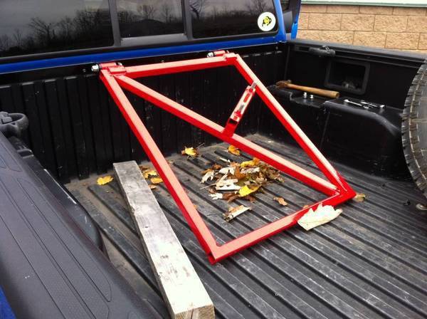

    Heres the final product!!!
    I have to admit im rather pleased with how it came out.

    That's awesome! Glad I could give you the idea for you to do it. I like the D-rings on the rail too. I did split some rubber hose and zip tie it to the corners where it sits on the bed. It was starting to wear grooves in the floor. How are you planning on securing it down?

    For sure man you def gave me all the ideas!!! I figured since I was losing my movable track my system and the anchor points I'd simply weld the D do GS in the best spot. Secure it in what way? So it doesn't get stolen?? I'll also admit I'm thinking of further following your lead and putting my hi lift jack, a shovel and an ax underneath it for rescue/recover stuff.

    I don't fly that much so its not a huge issue. I think I'll be putting some hose on it to keep it off the bed.
    On another note how did you do your cross bar, for when your tire is up? I need to set mine up.

    that's what i was curious about with this set up. i want to start building mine i a few months (moving into a house with a garage). i looked at all pro's and they have a locking pin setup at the hinge. it locks the hinge in one postion or the other so it doesn't bounce.
