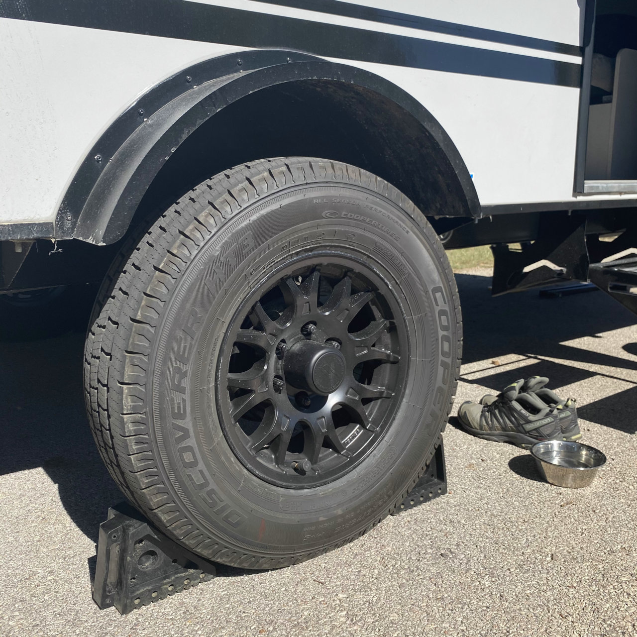

    Here's another upgrade that I'm really glad we did. ~2" factor lift, 16" wheels, and 31" E-ply tires. The Cooper HT3 running at ~60psi (per manufacturer weight table) rides SO much better on the highway at 70mph and on gravel roads out in the wild. Being a single-axel trailer, I didn't want to mess around with crappy rubber.

    Those look great! Yes....very wise to not cheap out on the rubber! I guess I would be inclined to do a couple of light shake out trips in the factory tires (just to get some satisfaction that there was a little bit of use on them), then swap then out. Did the 31's raise you even further than the "off road" tires that came with the trailer?

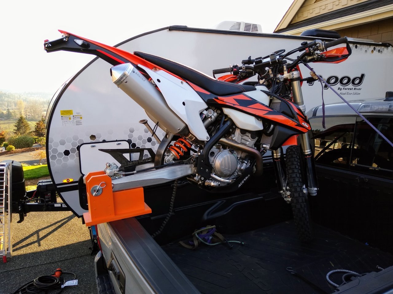

    why not put a receiver hitch on the back of the camper and a bike carrier? that looks like a PITA to deal with

    Studied on it, but lots of isuues, tongue weight gets light, trailer warranty, would need additional set of tail lights, etc.

    We did our first trip (1.5 hour drive) with the 28" OEM tires on 15" wheels, which were max 65 psi, and supposed to be run at 65 psi. 65 mph was okay, and I really didn't like how they ran at 70 mph.
    The HT3s are about 1/2" wider and (obviously) taller. Max rated for 112 mph and 80 psi, which means a much nicer ride when set to 60 psi and running 70 mph on the Texas highways. My lady even commented on how much smoother the ride was when towing. I also like that the sewer dump is over a foot from the ground.

    Out of curiosity, how much weight does that put on the tailgate? It’s sprung of course so no hard hits, I’m just thinking about all those creases in tailgates from people forgetting and leaving them down when turning.

    Not much, I'd guess 40lbs. Quite a bit of tension going forward above the CG from the tie downs. Not to mention I pretty much have it standing on it's nose.

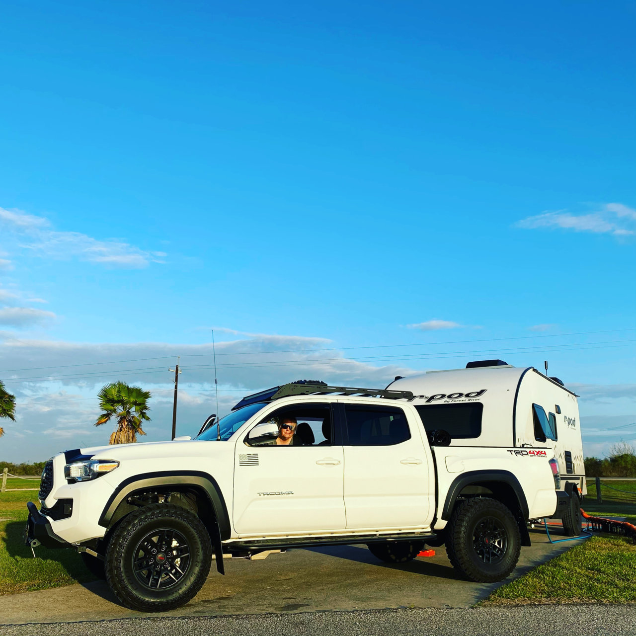

    31" E-ply tires at ~60 psi really improve the towing experience.

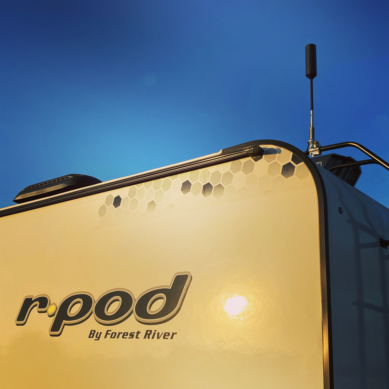

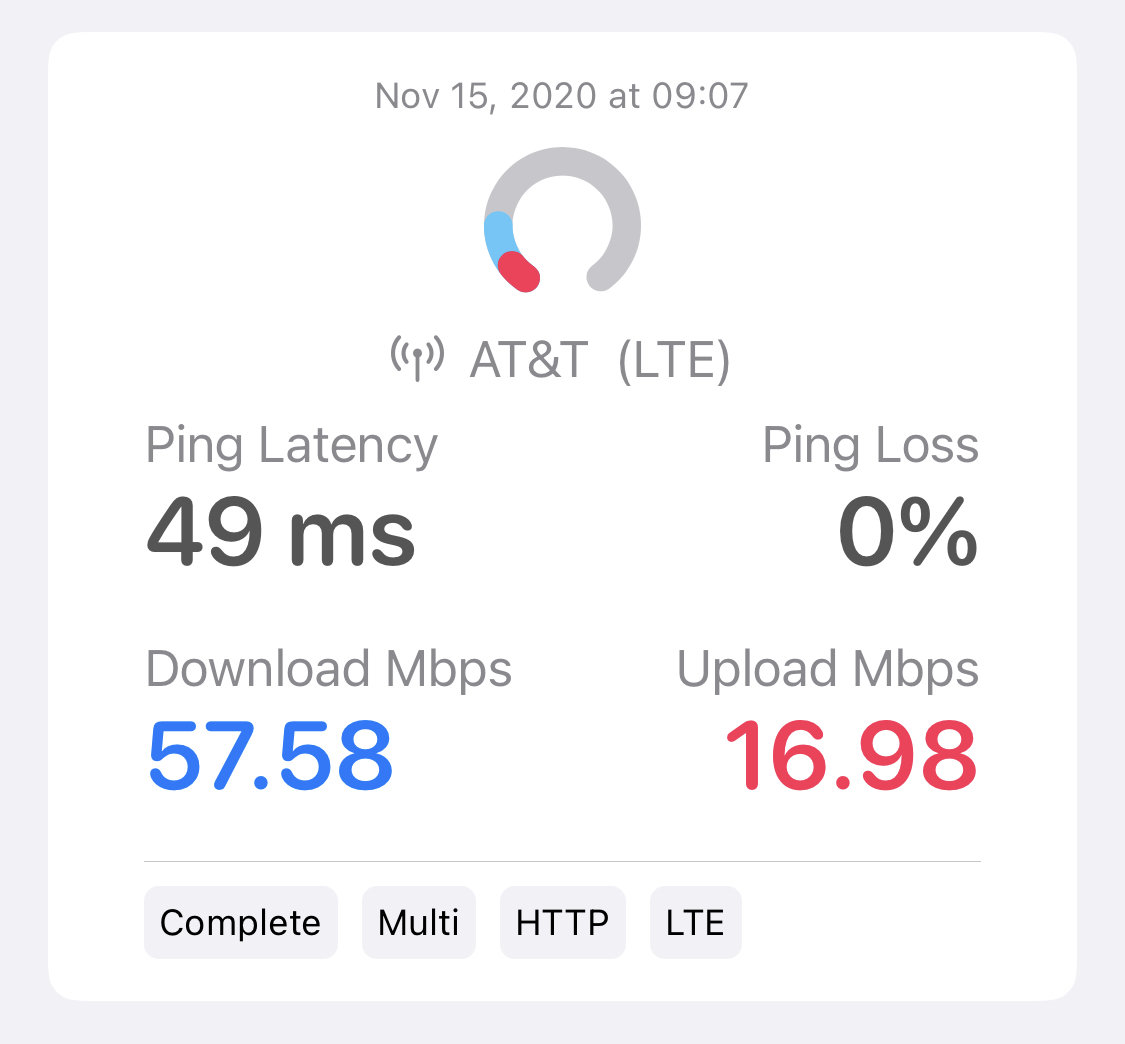

    We made another beach camping trip last weekend and had an opportunity to test out the newly installed cell phone booster. I wanted something that provided measurable improvements (I have some cellular test kit), could run off the 12v system, and was a passive booster with no monthly recurring charges. Decided on a Reboot Reach kit from Signal Booster. I was able to mount the external antenna to the ladder and route the cable through the same path and hole used for the TV antenna.
    Where we were camping, I had one (maybe two) bar of service outside the trailer. Inside or next to the trailer, connected to the booster, signal went to 4-5 bars and we were able to easily support video streaming.

    Nice work on the mount, looks good. We had good phone and music service, but struggled with streaming. I will look into that booster.
