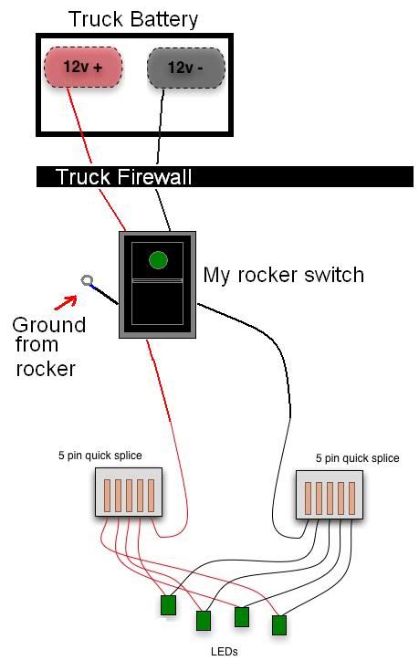

    I'm still kinda confused how you hook up the LEDs. Can you completely explain to me? PM. Thanks. And I have the seat and dash lights. I just need to know exactly how to hook up other interior lights. How to wire
    EDIT: well the picture helped. I just need to know exactly what to use so I don't blow a fuse or something. And how did you hook it to the battery?

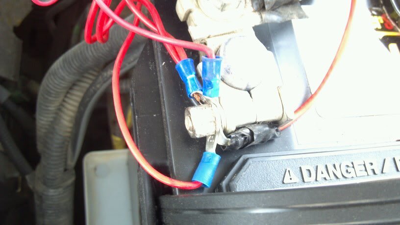

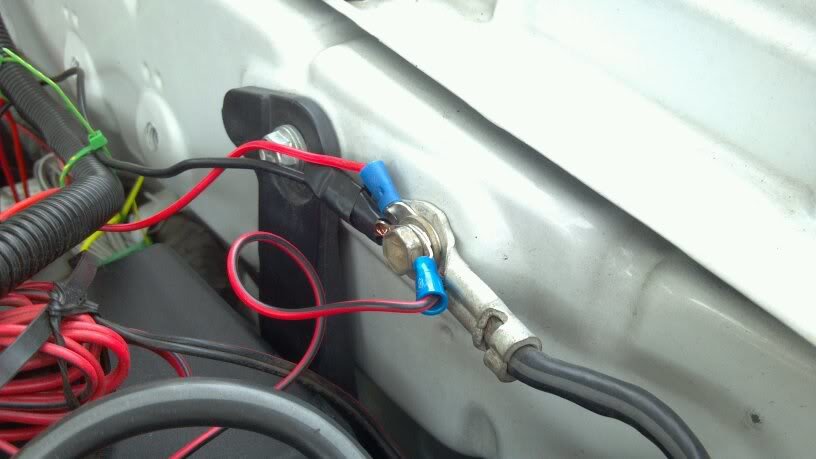

    Hey bro, I was wondering if i could get a pic of how you hooked up the wiring to your + and - terminals. I have my cupholder and floor LEDs in and it looks great with the 9volt battery tester, just need to connect it all up right and i'll post pics.
    thanks
    also, under body kit is on the way, lol
  9. Apr 6, 2012 at 4:28 PM
    #189
    Oregon TRD
    Oregon TRD [OP] "GO DUCKS" Edition
    Oct 16, 2007
    #3081
    15,316
    Ross
    Steel Panthers bathroom floor!
    2005 Mall Krawler
    6" Fabtech Lift, 35" Fierce M/T 17" Eagle Alloy Sim bead locks Naked girls in the bed 10.1" DVD head unit Two 7" Headrest Monitors PS2 in glove box
    Body kit....Awesome!
    Heres some pics....

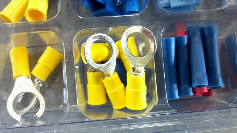

    I used two of these to put the positive and the negative wire into...
    Then put the negative one under this 10mm bolt
    Then the positive one under the bolt on the positive terminal

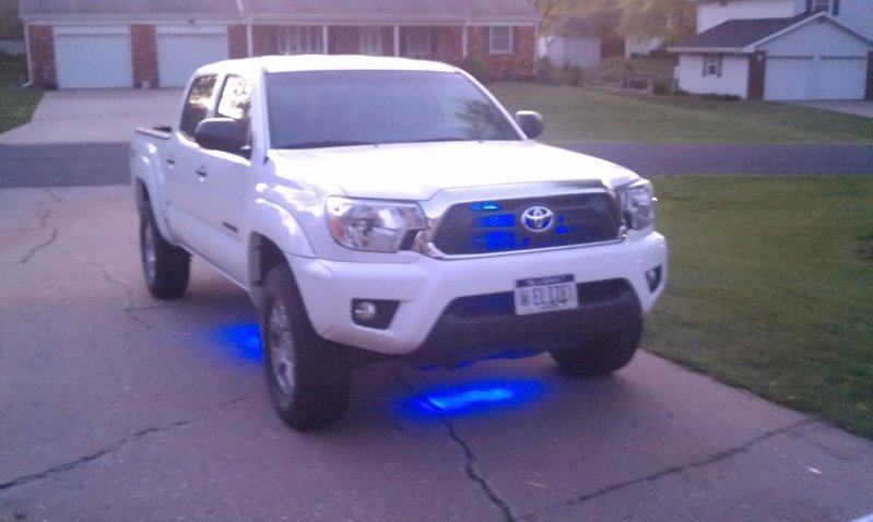

    well here is the body kit for now. I have to finish running power wire for the inside ones, then i'll get pics of those. I am going to wire my bed lights with a single pole double throw switch and run it like a dome light. Pics when that is done as well....
