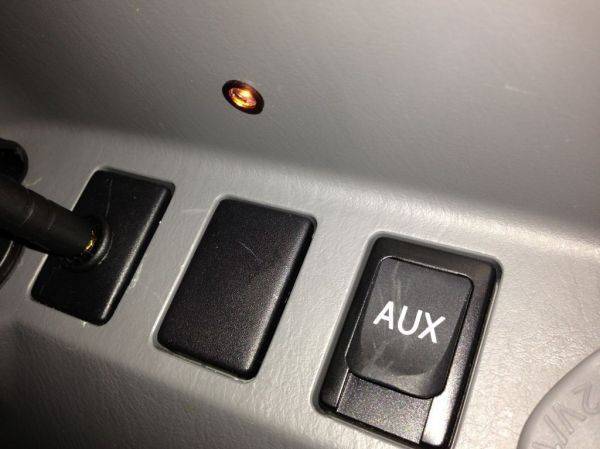

    Finally got an LED installed in that overhang below the HVAC controls. Here's some teasers, will get some night shots sometime soon:

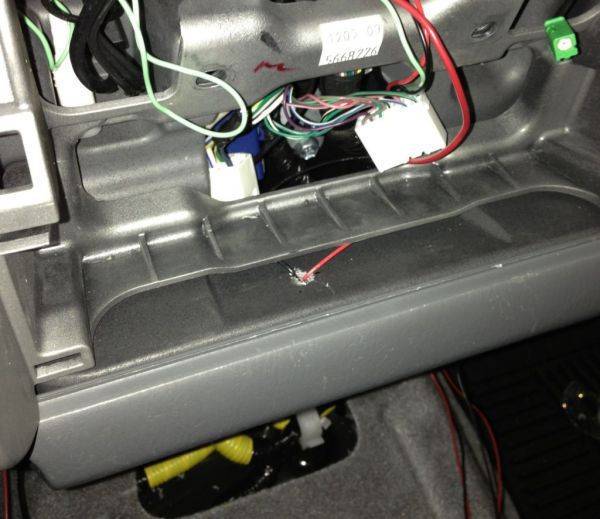

    Here's what I did to mount it in that area below the HVAC. I didn't feel like taking the whole dash apart to get to that piece, so I just drilled through the top piece that blocked that area and then drilled through the bottom in the overhang. I'll try to get a picture of that at a later time, but here is the finished product, I'm very pleased with it.

    YES!!!! More pics of where you drilled and how? My big ole drill prob won't fit up in there?????
    Excellent job but I def want more pics because I really need to do this.

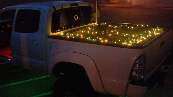

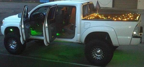

    Just bringing my LED shat on this page for shits n giggles since we are getting a few pages deep.:D :eek: :cool:

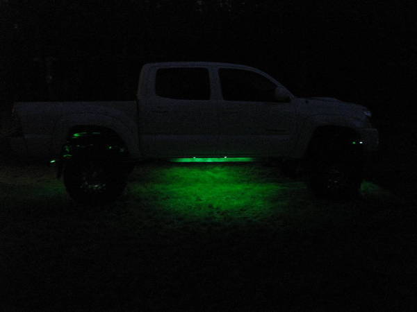

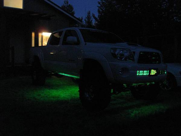

    Under Dash and Seats kit:
    Scanner:
    Undertruck Kit:
    LED cupholders, center console, glovebox, rear vent:
    Bedlights:
    Other shit:

    I actually took my head unit out and that gave me enough room to drill straight down through that shroud piece that blocks you from the roof of where I put the LED. I used a pretty small bit to drill the first hole and incrementally increased it until I got to 1/4". The first picture shows that first drill hole (it actually provided a good place to wire the LED from) and then a night picture as well I took last night on my phone.

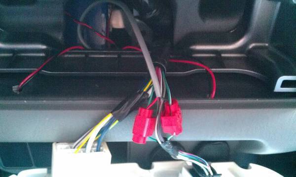

    I actually tapped the dash light circuit down at the shifter panel on the floor for automatics. I then ran that to the WAGO clamps that rapr mentioned earlier and mounted those under the cupholder console area. Fishing the wire leads up to that area where I mounted it was a bit of a pain (had to tape them to a long straw to pull them through) but it probably would be easier to tap the wires behind the HVAC. Somewhere here is a thread (I think the lighted 4x4 switch DIY thread) that shows which wires you tap into.

    That's just how I did mine. I drilled straight through but I put in 2 led's.

    Yeah I tapped into the HVAC I think the green & green/black wires on the smaller plug. I used a test light to figure it out, I can check later to confirm.

    So I went & checked when I took my break, it's the green & green/white wires. Green is + green/white is -.
