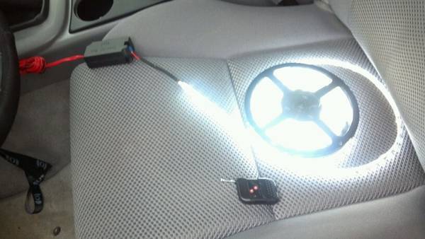

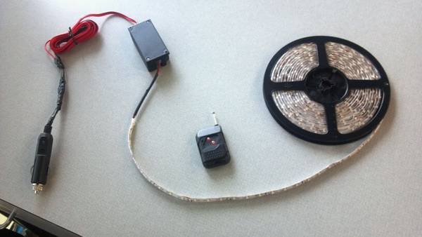

    Got my bedlights. Wired them into my remote control box then quick splice to a cig lighter to see if they work and BAMMMMM.....................B R I G H T !!!!!!!

    So - these came with a plug ready for a dc plug in ready to go.....but i cut the plug off and you have a red and black wire.
    I bought the remote control kit so i can turn them on and off from wherever I am....sittin by the campfire and kids want shit out of the bed...BAMM push a button and they can get there own shit..LOL. Dont have to open the truck up and hit a toggle.
    Anyhow - yeah...red positive black negative and good to go.
    After thinking it thru for a week or two, i'm buying this to put under the rails then putting it along the led strip so it sticks like a charm. It's black so you won't see it and will be strong enough because the LED strip is light.

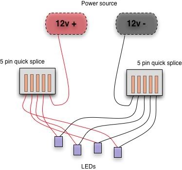

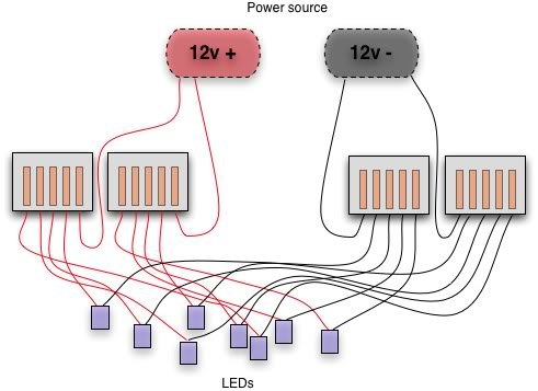

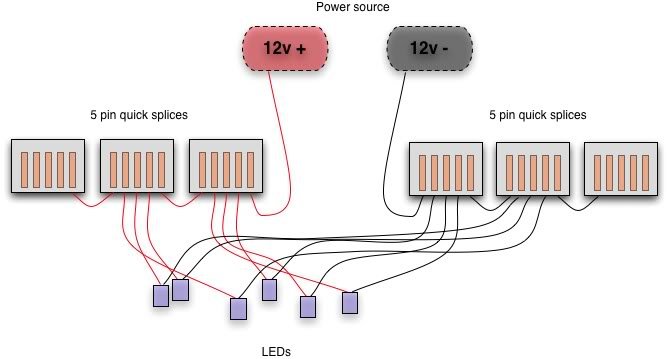

    WAGO diagrams in case someone needs them:
