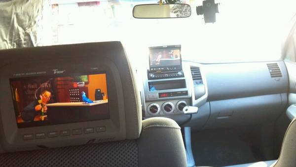

    I just got done hard wiring my two headrest monitors so my bed lights are next.

    Dude can I get some pics of the headrest monitors??

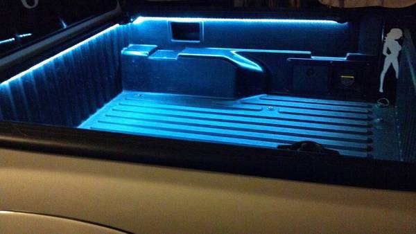

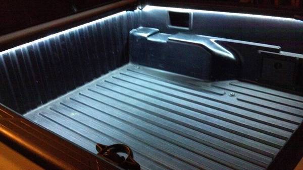

    BEDLIGHTS ARE DONE!!!!!

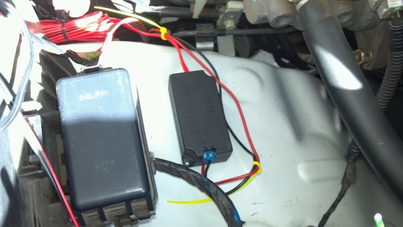

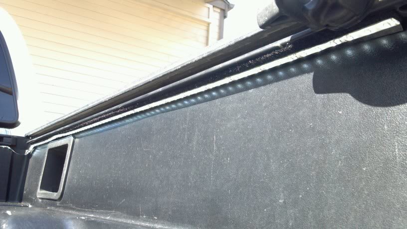

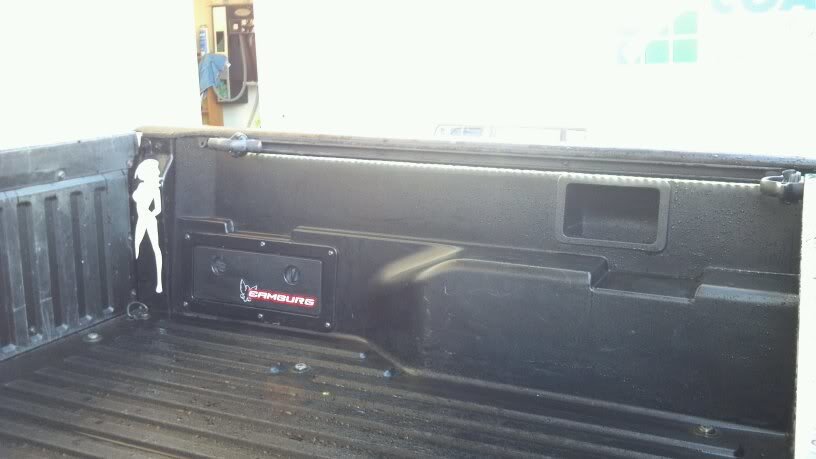

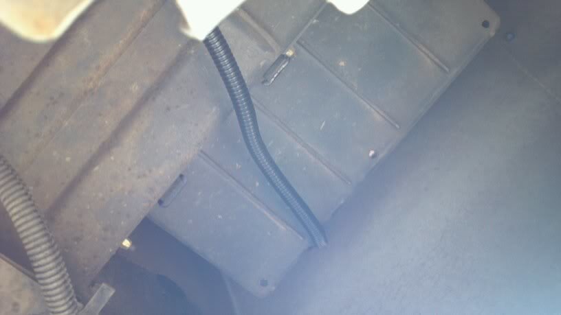

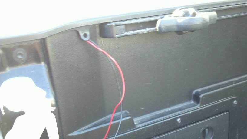

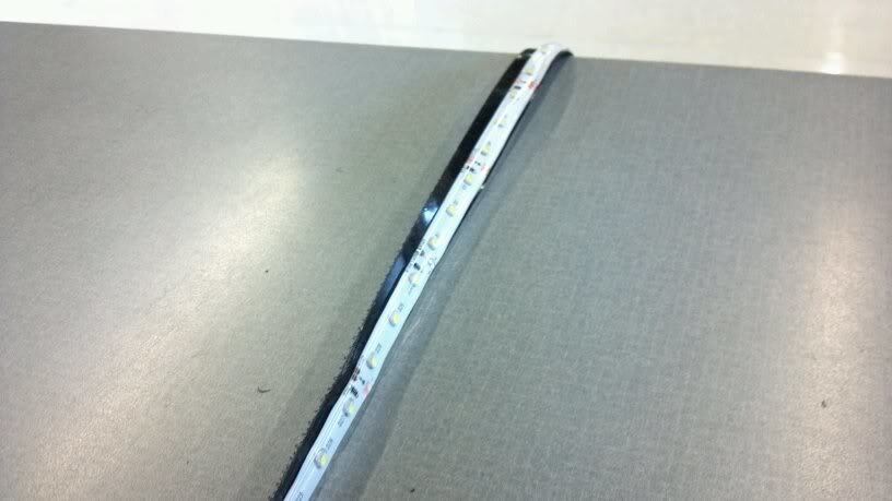

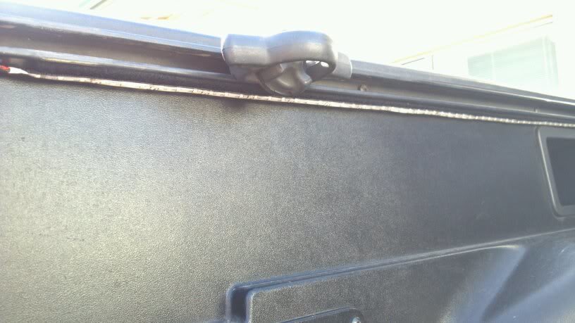

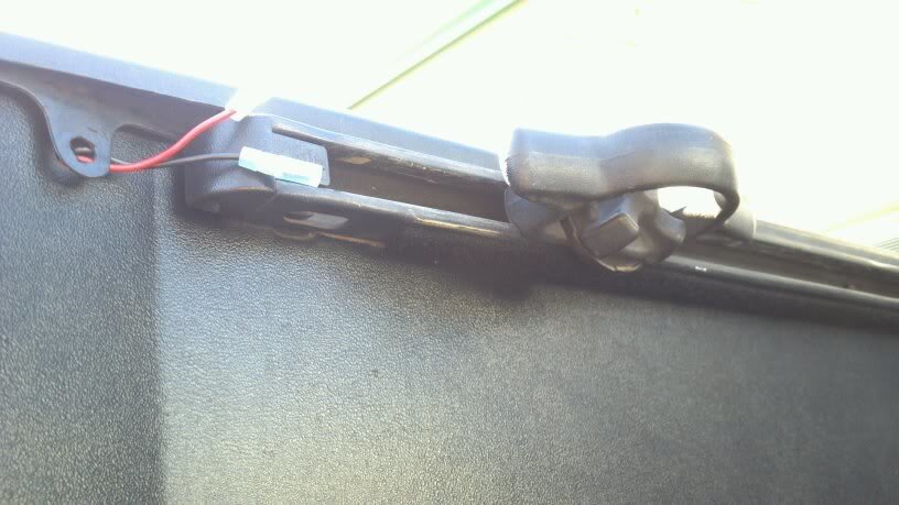

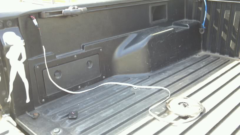

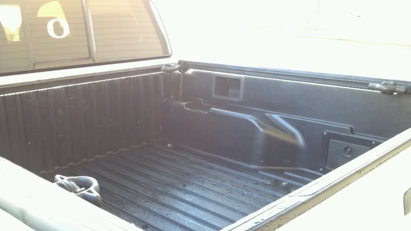

    First I mounted the Remote Control Box in the engine Bay.

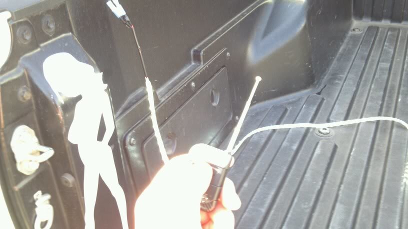

    Then ran the wire from the bed thru this hole and ran the wires inside the truck frame up into the engine bay and into the remote control box:
    This is under left rear area where the wire came thru ^^that hole, I put wire loom over them to make it cleaner

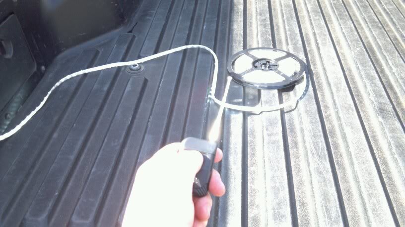

    Hooked up the remote control box to the battery then hooked the lights up to make sure the remote was working:

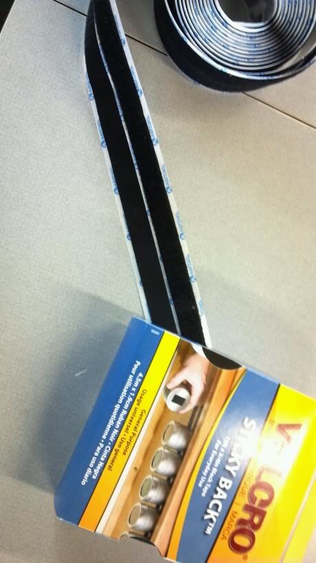

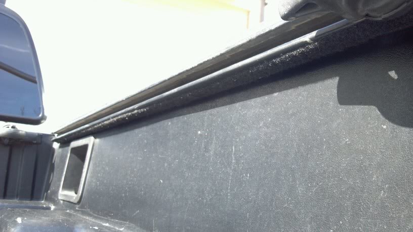

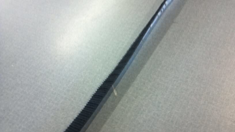

    Then I stuck the furry VELCRO to the underneath of the bedrails:

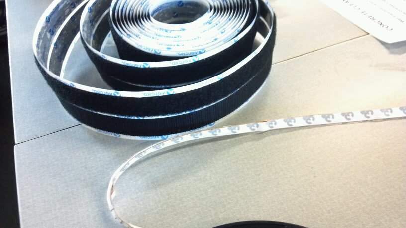

    Then the fun part!!:rolleyes:!! Sticking the 3m sticky backing of the LED's to the VELCRO Hook n Loop sticky backing...This VELCRO shit is amazing! It sticks like crazy!!!
    And I can take my lights off of the velcro if i need to fix, replace or whatever, they are completly removable but WON'T JUST COME OFF...you gotta PULL it so it's good to go!

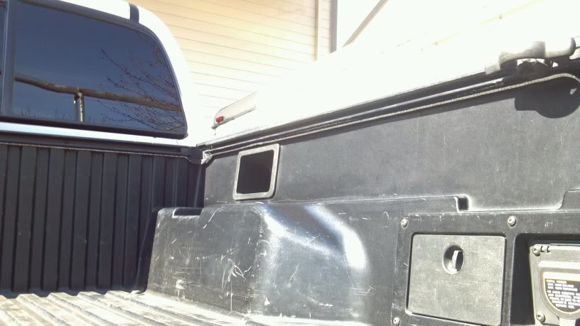

    Then took the LED's and VELCRO'ed them up under the bedrails to the other VELCRO and DONE!!!!!
    I'll get some night pics tonight.

    Lights are looking sweet! My plan is to do something similar at some point, but use cable straps to the rail bolts instead of velcro. Where did you buy the lights?

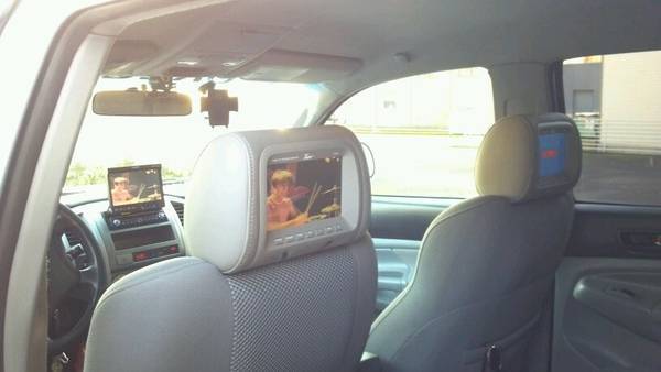

    That looks great. LOVE the Tvs!
