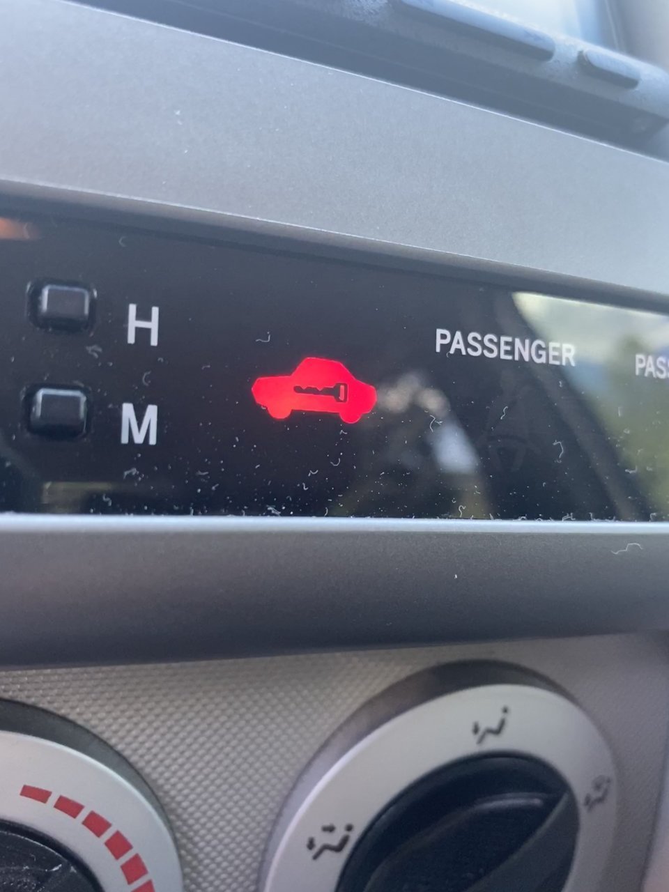

    Is the red security light flashing in the middle of the dash near the clock with the key on?

    I've never seen that red light. Maybe i don't have it, maybe the light burned out before i got the truck?

    It looks like this on my truck.

    I definitely don't have that. I'll take a picture of my dash tomorrow

    As far as I know all 4.0L trucks have an immobilizer and should have a security light, it blinks once every few secs with the key out but should go out when the key is inserted.

    I see it looks like you have or had an aftermarket security or remote start system (little indicator light drilled into the dash to the right of the switch blanks is a telltale sign of one being present), those can do some crazy stuff when they act up depending what all they are wired into.

    I missed the security light in the video. Good catch.
