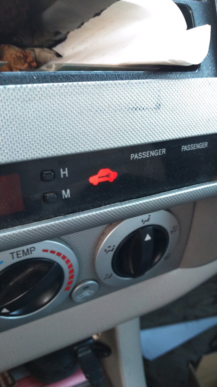

    EDIT- she still won't start, but now my immobilizer light is actually blinking.
    It blinks while the key is Not in the ignition And it blinks while the starter Is cranking.
    (I'm not sure when it is/isn't supposed to be blinking).

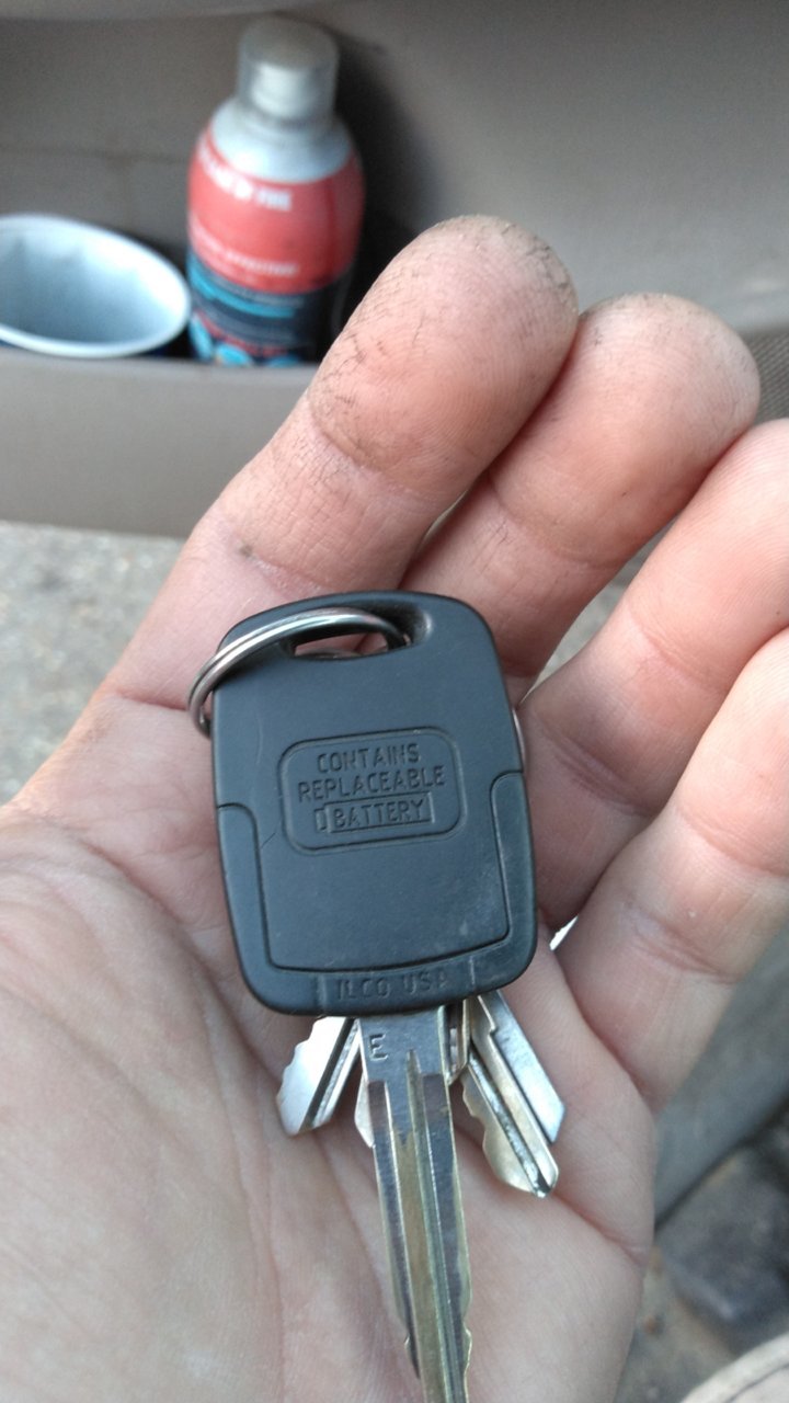

    Update, since this is definitely seeming like an imobilizer issue, go ahead and laugh your ass off at me... I'm an idiot
    Let's see what the inside of my janky aftermarket key looks like

    I’m pretty sure it is supposed to stop blinking when the key is in the ignition.
    I’ll be headed out the door here, in about 20 mins. I will check to see when mine goes off.
    I know it doesn’t blink when cranking for sure.

    Mine stops as soon as the key is inserted, you may have to find someone with a scanner that can talk to the imobilizer module.

    Update for you OP
    Mine WILL continue to flash with the key in the ignition in the OFF position.
    It STOPS flashing when in the ACC or ON position.
    FishaRnekEd[OP] likes this.

    Okay here we go she might be fixed finally ‍♀️.
    Years ago when I first got the truck it was having some funny electrical issues doing all kinds of random shit I tore the dash apart and found that the previous owner had wired in all kinds of bullshit probably remote starter stereo crap possibly their own security system.
    Back then I put all the wires back together tape them and secured them didn't have any weird problems anymore. I also never had my immobilizer light come on I didn't even notice it and I assumed this thing just didn't have that security system.
    It appears now that the security system was inactive for some reason somehow turned off it may have turned back on a few weeks ago when I had the battery disconnected for a long time.
    That in combination with my shitty key might be what was giving me the intermittent no fuel issue. I just changed the battery out in the key and tighten up the spring inside that was holding it it was jiggly and I never noticed.
    I just did a hotwire reset on the obd port this morning and the security light came on, which had never come on before. That's when i checked the battery in the key.

    Look at my post #34
    There was probably a weird issue with the imobilizer and it was never working until i had the battery off of the truck for several hours (used it to get a guys boat running).
    Look at the picture of my shitty key
    That must have done a soft reset on the computer system. Then when i did a hotwire reset, the imobilizer started to fully function.

    My
    My flashing light works now exactly as tnshooter describes!
