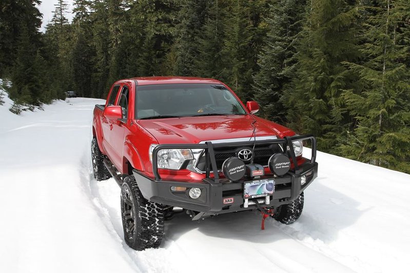

    The stock suspension is really starting to show stress from having the extra weight of a ARB deluxe + winch on it for ~15-20k miles. After looking around it came down to either two options:
    OME HD kit with 886 coils, Dakar leafs, & LR UCA (hard to pass on with the current 30% sale)
    or
    ICON Stage 1 w/ LR UCA (keep revtek rear spacer block in)
    I've been leaning towards the ICON due to mixed reviews on the 886 being either too rough or clunking on speeds bumps (not being loaded down enough). I only tow maybe 3 times a year and most of the offroad driving is fireroads etc.
    Wanted to see if anyone had a similar situation and had any advice (Picture is before i put the ARE CX Canopy on)
