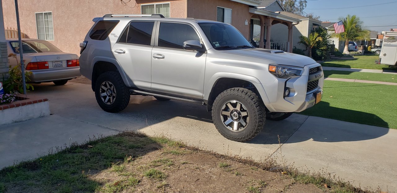

    I'm assuming lifting the T4R is similar to the Taco in the front, but what about the rear? Can't be as simple as just springs and shocks, right?

    Very simple to do the rears. loosen upper and lower links but do not remove, remove shocks, use spring compressors and get the springs out. Install is the opposite. Super easy to do and that's with KDSS also! :thumbsup: I don't understand why people say installing a lift on a KDSS 4Runner is difficult :notsure: It couldn't be anymore easier :thumbsup:

    Should be simple then, especially since I don't have KDSS. Just wasn't sure if there are any additional parts that need to be upgraded. Most likely going to lift 3" like I did with the Taco.

    Cool! I originally had it at 3" in the front and 2" in the rear but my 4'11" 65 yrs old mom struggles to get into my truck so I ended up lower it to 2.5" and 1.5" to help her out. :thumbsup:

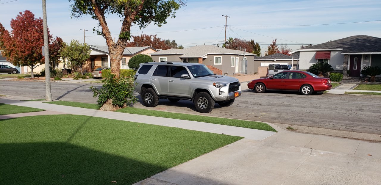

    That lawn yo :rofl:
    4Runner looks great!
