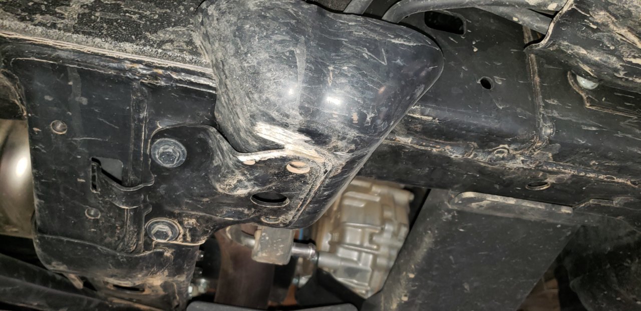

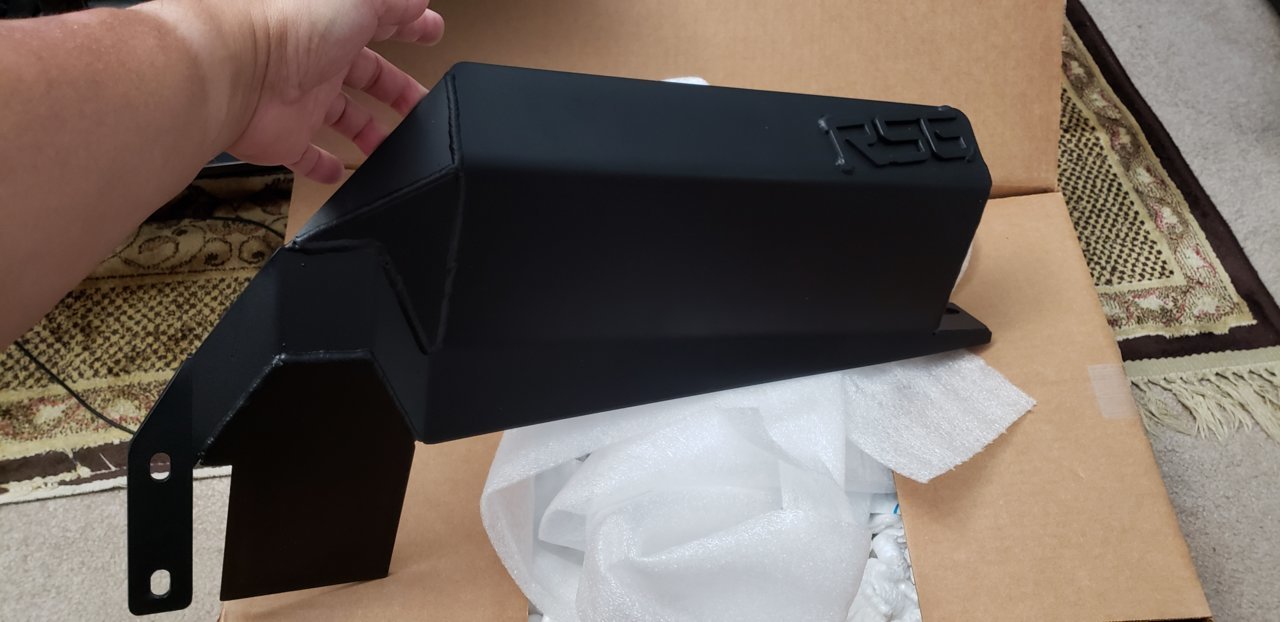

    KDSS skid came after I bashed the stock skid on some rocks:

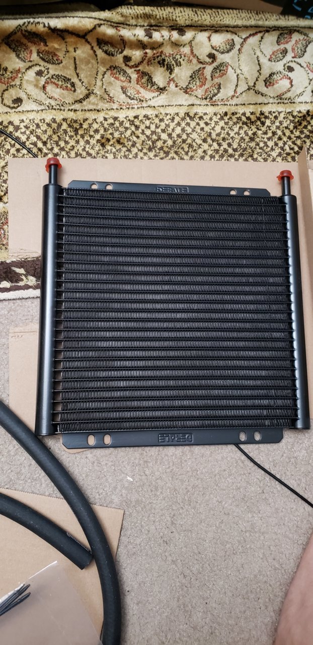

    Another mod added. Noticed when I was climbing from 2k to 10k ft on the last wheeling trip my tranny temperature was going up from 190 F to 220 F while I was in 4H. Switched to 4L and temperature dropped back down to 195 F. Less stress on the drivetrain. Didn't help that I was loaded so I figured a tranny cooler upgrade is in order.

    $65 on Amazon which isn't a bad deal and added insurance for the tranny since heat is the #1 killer of transmissions.

    Nice how hard are those to install?

    Super easy. It runs in series with the factory small cooler the 4runner has on the bottom of the radiator. 45 mins max.
