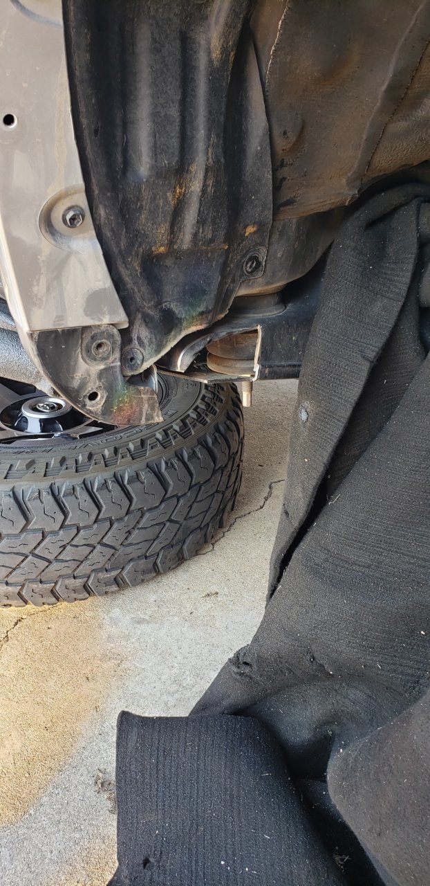

    I left the pinch weld alone unless it becomes a issue.

    Nice, I'd only mess with the pinch weld then too. How those Dobinsons working out?

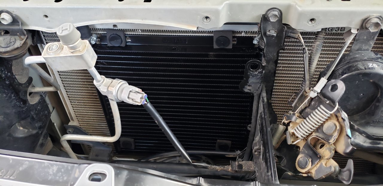

    I had a chance to put this Derale tranny cooler to the test this past weekend trail trip. The 4Runner pulled itself up to 8500+ Ft elevation with no issues of overheating. Ambient temp was 86 deg. I was seeing 150-185 degrees max! in 2H and 4H. My prior trip before the cooler upgrade was going up to 10500+ ft and it was heating up to 225 degrees in 4H at the tranny pan based on the scanguage. Ambient temp was 84. I had to drop it down to 4L to keep the temperatures down on the climb up the mountain. For roughly $65 from Amazon this thing paid for itself and a great added insurance protection for the transmission :thumbsup:
    This is the one I got BTW: https://www.amazon.com/gp/product/B004XONRYK/ref=ppx_yo_dt_b_asin_title_o05_s00?ie=UTF8&psc=1

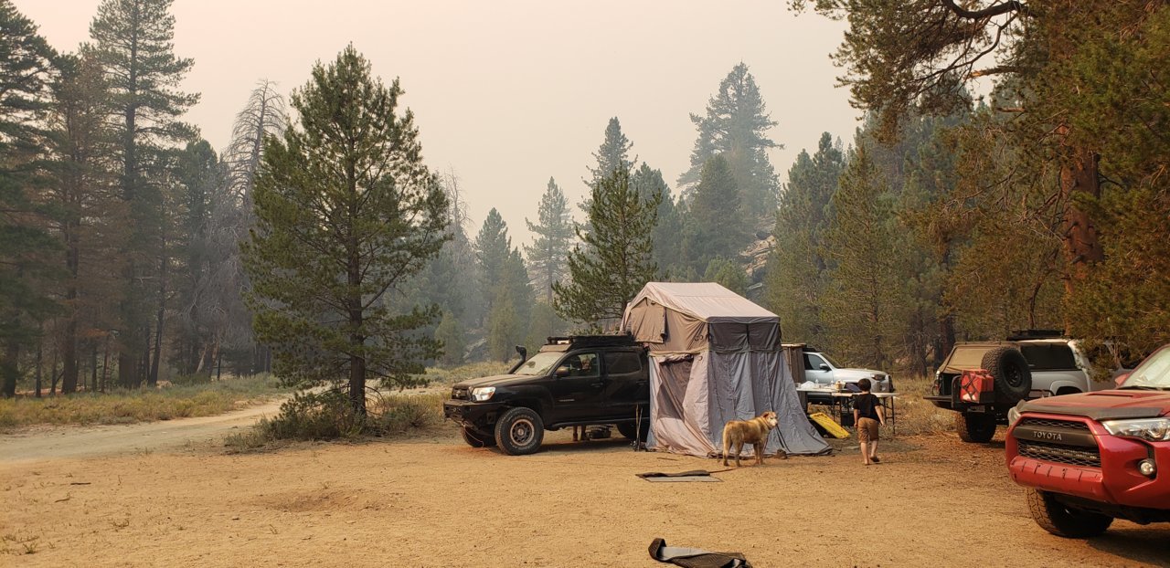

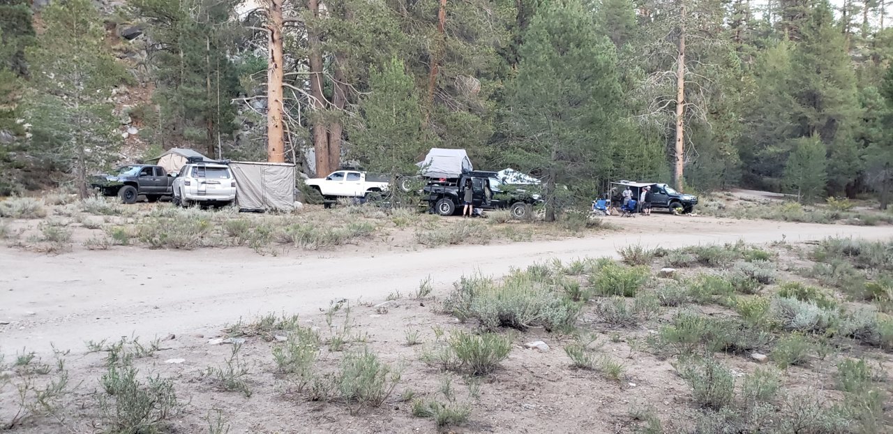

    It does
    Before:
    Getting smokey and ashy:

    Nice turn out. Looks like some fun was had before bailing.

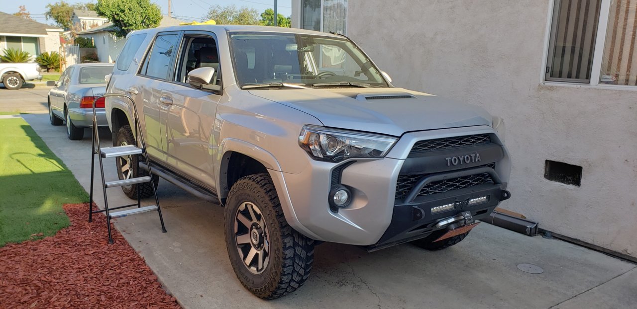

    She looks naked without her rack on...
