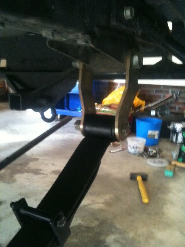

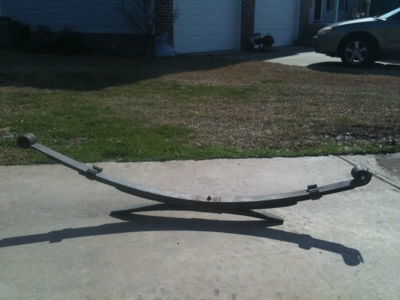

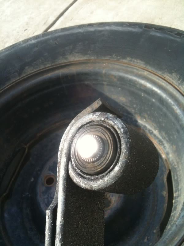

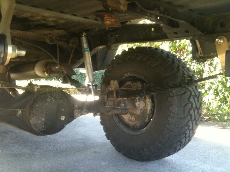

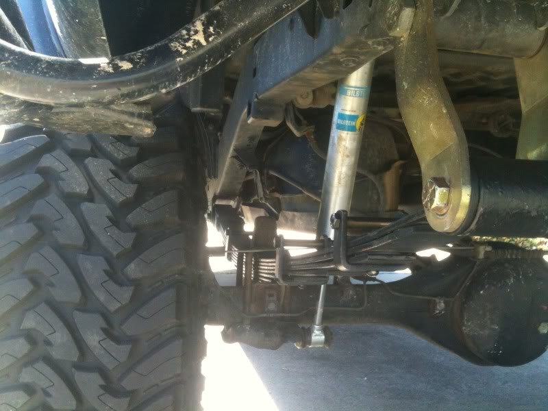

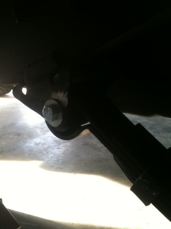

    I finally got my front leaf spring bracket bolts out. 14 years of grime and rust seized the bolts up in the rubber bushings real nice so I finally just cut them out with a sawzall.
    The OEM springs were shot to shit and my rear end was sagging pretty nicely so it was beyond time for them to be replaced. It took about four blades total to get them out.
    I ended up putting some Grade 5 1/2" x 4" bolts in there and they fit real snug. I was hoping for Grade 8 but 5 was all ACE Hardware had.

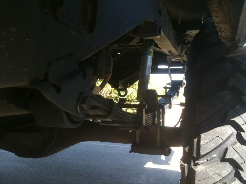

    Finally level and fully lifted in the rear.

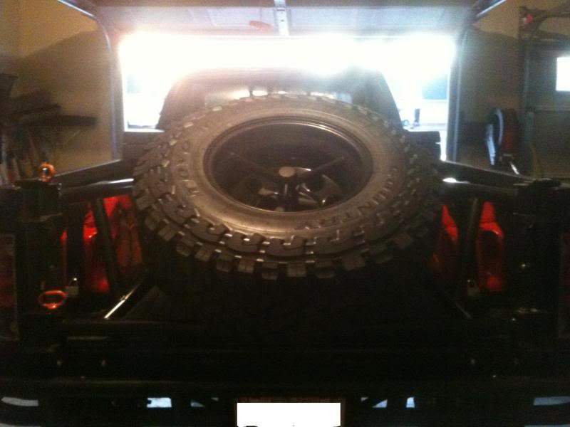

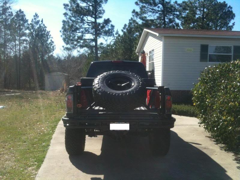

    Awesome! Can you pull that thing out of the garage and give us some more pictures??

    Sure thing. I'm working on her now so I'll snap a few.

    Did the leaf pack come with new U bolts?

    Nope, had to buy them separate. They won't fit in the standard u-bolt plate and I have to wait til I can weld on the new shock mounts to the axle.

    Id upgrade those bolts asap... Check to see if theres a Fastenal near you, theyll have the bolts you need
