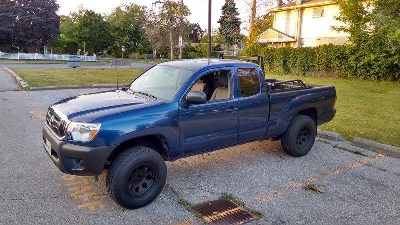

    Before, obviously...
    After.. :)
    I used a Procomp (Nitro, PN 65660K) Lift kit.. It's the same as Fat Bob's or Readylift. 2 3/4 front block and 1 3/4 back AAL.. I also installed Procomp wheels PN 7069-6865 16" with 4.5" backset -12 offset, flat black and Bilstien shocks 4600's front 24-185066 passenger side, 24-185042 drivers side and 5100's rear 24-186728. (everything above is available right here in Canada at 4wheel or any 4x shop for that matter) Gorilla lug nuts 21133BC and extended studs ARP PN 100-7715 (I had to cut 1/2" off them). I picked up hub rings and ARP's locally at a rim shop after measuring what I needed (60.1 x 83) Not really offroading so I went with Michelin Defenders 265/70/16
    I used the truck as a spring compressor, it was no big deal. I followed the readylift instructions accept I added a step to get the Bilstiens in. I lowered out the entire assembly.. Pic.
    It's hard to tell but the spring is fully decompressed. I simply pulled it out, swapped the shock, put it back in, screwed in the top nut and then pulled it out with the top and installed the lift block as per instructions..
    Anyways, It's driving well, could probably use an alignmet. I'll take a shot at it myself tomorrow, if I'm unhappy I'll take it to a shop on Tuesday ( Holiday Monday (Simcoe Day) here in Canada) ..
    Otherwise it went smoothly.. Of note, in the instructions they tell you to rotate the strut 120 degrees to line up the studs.. I see through reading through some of the other threads some of you missread that and assume it says 180 degrees.. What they really mean is 60 degrees (I assume the authors failed math) and the process is overstated.. All you have to do is twist the bottom of the shock to get the bottom mount lined up after attaching the top.. Make sure the brake line bracket is pointing out and you're set.. Also of note.. The bilstein brake line bracket is a wee bit larger that the stocker, so it need a wee bend to fit.. Everything is extremely tight up front untill you get the wheel on and drop it off the jack stands.. Also worth noting, I had to grind 1/8th off the rotor bracket to get some clearance for the new wheels.. Not a problem..
    Shout out to HackD. He answered a few questions, confirmed some suspicions, boosted my confidence in a few PMs..
    Anyways.. I figured I'd share.. Good luck..

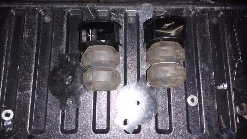

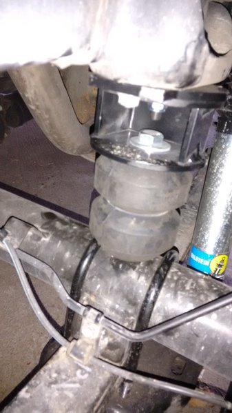

    IMG_20160810_191842993.jpg Added Timbrens Model # TORXR-P2. I also added a piece of bedframe (angle iron) along the top of the tailgate beneith the stock plastic trim, can't see it but it stiffens the entire tailgate. I work the truck at times. I was concerned that with a load it would hit the new 5100's before the stock bumpstops. I was looking for a new bumpstop and came accross the Timbrens. Answered the extra load issue as well as the bumpstop issue in one swing. Standard Timbrens for the stock 5 lugger are PN TORXR. With the add a leaf installed I needed a product 6" indstead of the regular 4" Timbren. Called them up, they were willing to help with PN TORXR-P2. It's a 4" Timbren with a 2" spacer. They're 1/2 the price of airbags, ride is totally unaffected untill a load is added. Hauled 20 bags of concrete this afternoon and the truck barely sagged. I'm stoked. I have some pics but the phone is having issues connecting just now, I'll add them later..
