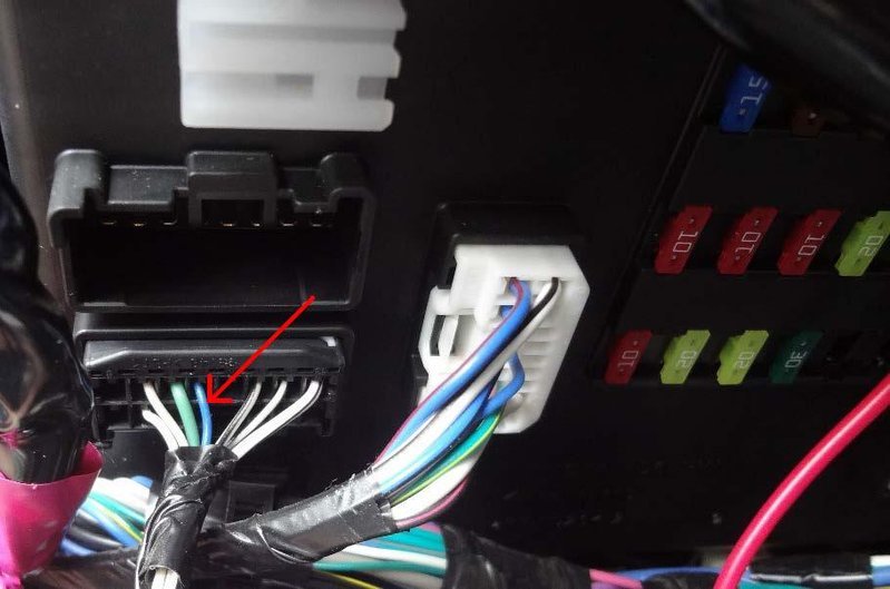

    Guys,
    Can anyone provide some advice for wiring OEM 4Runner mirrors? I have the pin-outs for the plug, just need tap connections points for rear blinkers and the puddle lights.
    For heat elements thought to do separate circuit using that timer/highlander mirror switch scheme provided.
    Thanks!
  19. Jan 18, 2017 at 3:51 PM
    #39
    Up2NoGood
    Up2NoGood Well-Known Member
    Jun 23, 2014
    #132511
    3,302
    Jaimes
    BC, Canada
    2014 TRD Sport DCLB
    What exactly do you want advice on? Just where to tap for the puddle lights and mirror turn signals? If so for the dome wire you need one end hooked up to a fused constant 12v source, through somethings like an add a fuse. The other end you need tapped into your dome circuit (assuming you want the puddle lights to mimic your dome lights). This is the most accessible spot to tap the dome wire, although you should test it on your truck first.
    I also attached a instructional file from a pair of towing mirrors that shows what wires to tap to add turn signal functionality to your mirrors if your truck doesn't currently have it.
    Are you planning on using the connector that comes with the 4runner mirrors or switching it over to something else? I have a pair of 4runner mirrors I'll be putting on too, probably in a month or so when the weather warms up a bit!
  20. Jan 18, 2017 at 5:03 PM
    #40
    firsttraxxx
    firsttraxxx Well-Known Member
    Jan 16, 2010
    #29459
    136
    NoVA-LoCo
    2013 Baja TX
    Fox 2.5 front / JBA UCA 3” Fox 2.0 rear / Icon RXT Stg 1 3” BAMF rear bumper Some cool mods
    That's it, perfecto! I plan to use the 4Runner mirror plug, connecting to whatever plug exists in my 2013 door (though it looks like the signal wires may need to be plumbed from fuse box).....will upload some pics later for reference ('13 to '15 models). Thanks again, great help and information.
