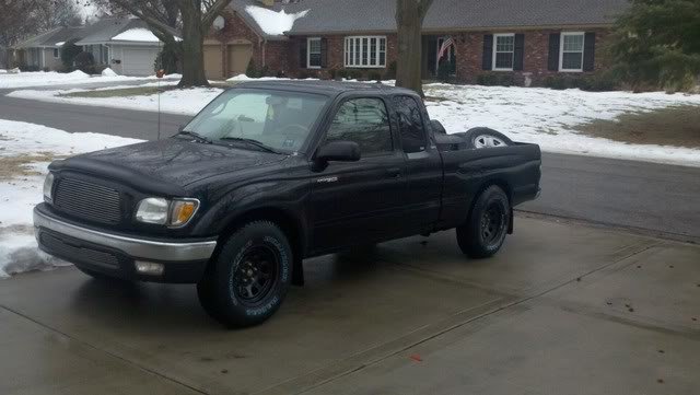

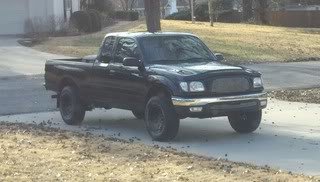

    Ok slight change of plans. With "The Beast", as the weather channel is calling it, coming through I decided to throw on my new tires to get some decent traction before the lift. They don't rub at all in turns, but I can definitely hear them hit the inner fenders on the top when I back out of the driveway and bounce down the curb. i definitely have some work to do balancing them, these tires have been a bitch compared to any other ones I've done. I thought I had it then when I hit about 55 mph all hell broke loose and everything was bouncing like crazy. Anyway here's what it looks like as it sits... (actually not quite it has about a foot thick white blanket on it right now, but you get the idea).
    I am very happy so far. I love being able to see the tires sticking out that inch or so in my mirrors. Also as you can see i'm being at the front of the "white letter out" fad so I'm not a follower later on. The lift should get put on now probably thursday and friday as I'm doing it at school and school was cancelled today and it is for tomorrow.

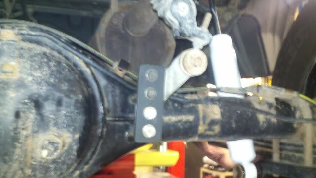

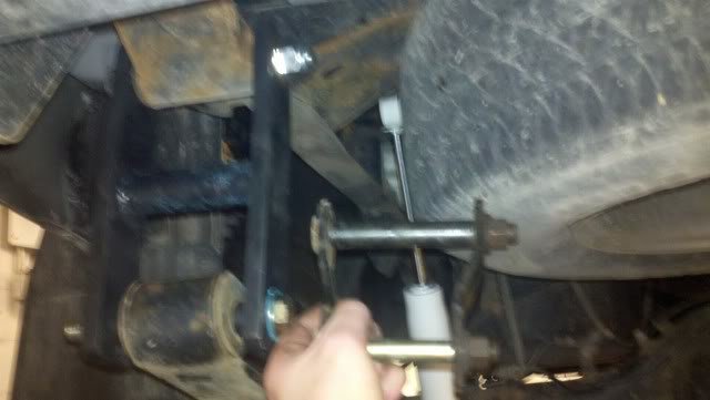

    Ok everyone. I finally got my time slot in the shop and some real progress. We've had to get a friend of mine's car put together to the point of being mobile as he's been waiting for a part and just sitting at a standstill for several weeks. I then naturally received the wrong shocks from O'Reilly and just ordered Doetsche Tech ones to make damn sure they fit this time (they also make a kit for my truck so I figured some shocks they had must work)
    I started off one day with the rear... got my Beefed shackles put in and my CORRECT shocks and my BPV bracket (Thanks Brian)
    These things really live up to their name. They are BEEFY (I'm holding the factory ones beside them.
    BPV relocation
    My truck kinda looks like it's mooning everyone now.
    The install took about 1.5 hours (would've been much easier if I had every tool in a spot where I knew what it was) and it was pretty straightforward. I just needed help from a friend to hang off the leaf again to get the shackle on (and didn't consider lowering the screw jack I had supporting the rear end, doh!) Just took lots of WD-40 to fight that wonderful Toyota rust.

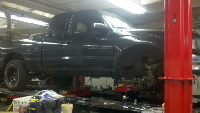

    DAY 2

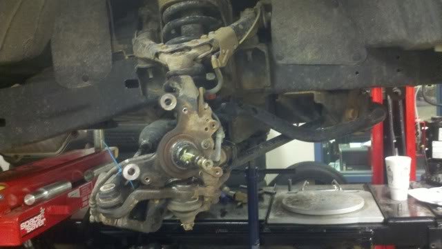

    Started in on the front spindles. They seem pretty daunting at first and not as straightforward as the shackles but not too bad at all. The first one took forever just to figure everything out (the instructions suck for these, I think they are made for 95.5-00 and some minor changes were made in 01 or something) and finding a damn socket in our shop takes about 6 hours. I'm also working on a lift meant for alignments and not for under car work, so getting in and out of it is kinda an acrobatic procedure that involves lots of hitting your head. After I got the first one off and all the tools I needed out the second one popped off in a jiffy. I got hung up trying to get the ABS sensors out and called it a day (hooray rust!). I should finish up tomorrow hopefully.
    How she sits now (stranded, gotta ride with daddy to school tomorrow :) )
    For anyone that's interested, the stock spindle

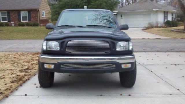

    DAY 3
    Done! :D :yay:

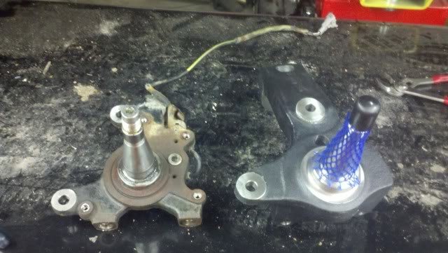

    Spent about another 3 hours today on it. Everything went pretty well. The seized ABS sensors finally gave up and I wish I could say I got them out. I sheared both of them in half so I'm rolling without ABS right now. Other than that everything went smoothly. Putting the calpiers back on was probably the hardest part and I ended up getting one on with the brake line twisted so I had to do it all again (that's always kinda depressing)
    Anyway the interesting part... pictures!

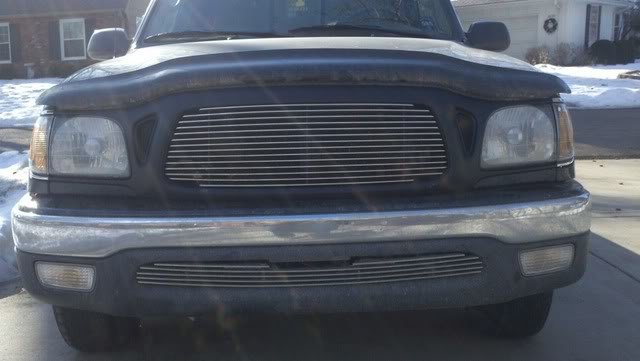

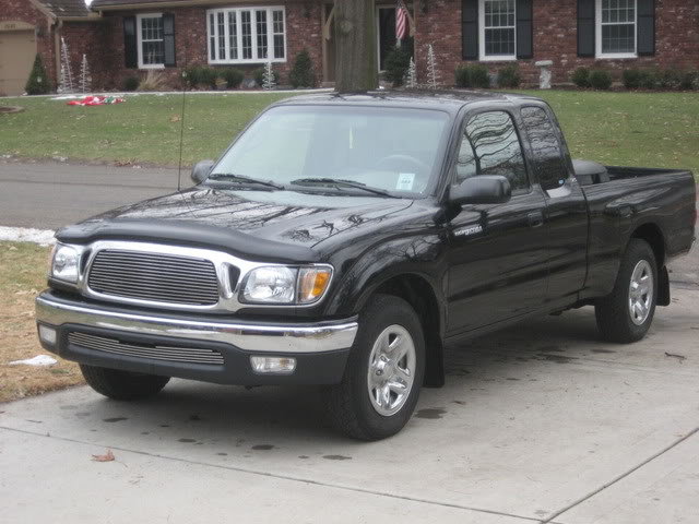

    Old vs. new (notice the damn ABS sensor wire still in the old one :mad:)

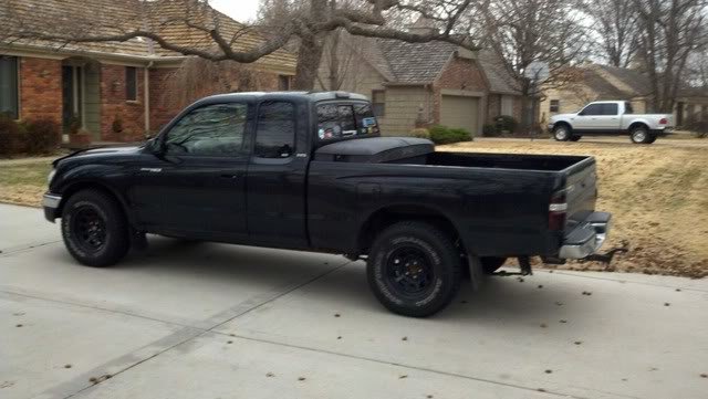

    Before Lift
    After Lift

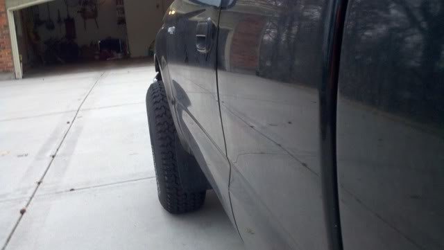

    This was one of the most drastic changes... front track width
    Before (not a great pic, but what I had)
    After

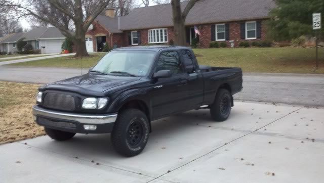

    From the back
    I definitely enjoyed the process and learned a lot. I'm trying not to drive it much before I get in to align it. I also need to order 2 new ABS sensors. Spring break is next week so I wont have it in the shop again till 2 weeks from yesterday. I also have front shocks to put on at some point and need some work on balancing the tires. Of course it'll never be done but that's it for a little while... at least for suspension :)
